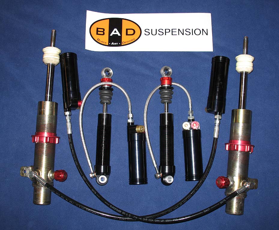

Some new toys for the Rallye

Very nice Dennis, I take it that little lot is in the process of being fitted?? When's ur next outing??

Where are the old ones going? This is by far my favorite car on the forum! Nice to have another update Big grin.

In the process of fitting it all now (have to work out where and how to mount the canisters).
Not sure when I�ll be out next � will start a thread in the Meets section once I know.
As for the old suspension, the front coilovers are my old ones with external canisters added (when I originally ordered them � we put the provision to upgrade them in the future if needs be). The rear Bilsteins are actually on loan from my friend and will be returned to him.
This was one of the reasons for upgrade � I needed to buy some new rear dampers anyway. Really like the racing Bilsteins, but ideally they need some adjustability. So we put them on the dyno at BAD, and then John designed new valving and adjusters to work in the required range.
A bit more info on the front setup:
- Eibach springs 250-550lb tender progressive and 650lb mains
- The strut bodies are shortened (compare to normal length) to get the piston in the mid-stroke position when the car is at the ride height
- ARB brackets relocated to return the ARB to the normal position with the car been lower

How much did these set you back Dennis if it's not a rude question?
Posted 26th Jun 2011 at 15:34

Price: I did it in stages, so worked out a bit more, but to do it from scratch you are looking in the regions of 2k. Not unreasonable considering that you get exactly what you want – designed for the car and your requirements Wink
Just finished fitting the fronts and took the car out for a drive along some country lanes. Have not played with adjusters properly – just set them midway. F*ck me it handles! The 1-ways were awesome and everyone who’s been in the car will agree. But now it is up on another level. Flat out on bumpy country lanes – just gliding along Cool Rides bumps better than my BMW LOL

Is that a 2.5" spring? I ask as I'm currently having clearance issues with my GAZ units, the spring collar and the sidewall of the tyre are touching unless I wind them right up the body. (8" slicks and 17" wheels) I'm already running a 12mm spacer on ET20 rims so I can't bring the wheels out much more.

That puts the front end of the car up in the air though. I could buy shorter springs but I like the longer ones as they are more progressive, plus I wanted to use helper springs so the full threaded length will pretty much be in use. I'm just going to have to run more track width Ninja

Modified 406 hubs help at all...?
Posted 27th Jun 2011 at 20:27
Post #124
Yours on 2.5" springs Jim?
Modified the spring pans on a few to fit 2.25's before but it does mean less travel for the same rate...
Posted 27th Jun 2011 at 20:33
Post #125
Yeah 2.5", less travel? I don't think I'll do anything drastic to the shocks just yet. I'll get some shorter springs for now, and come up with a solution if necessary when I upgrade the shocks later on. If I go for a 6" spring the collar should be well away from the tyre. Do I need to get a different poundage spring if it's shorter or does it still work out the same?
