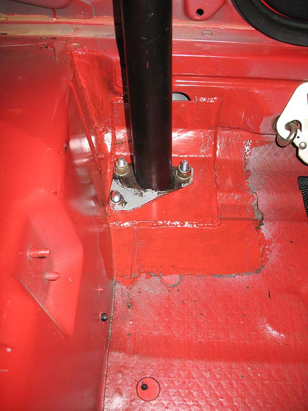

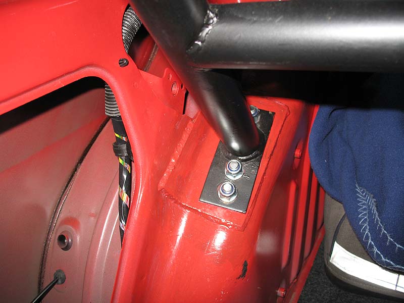

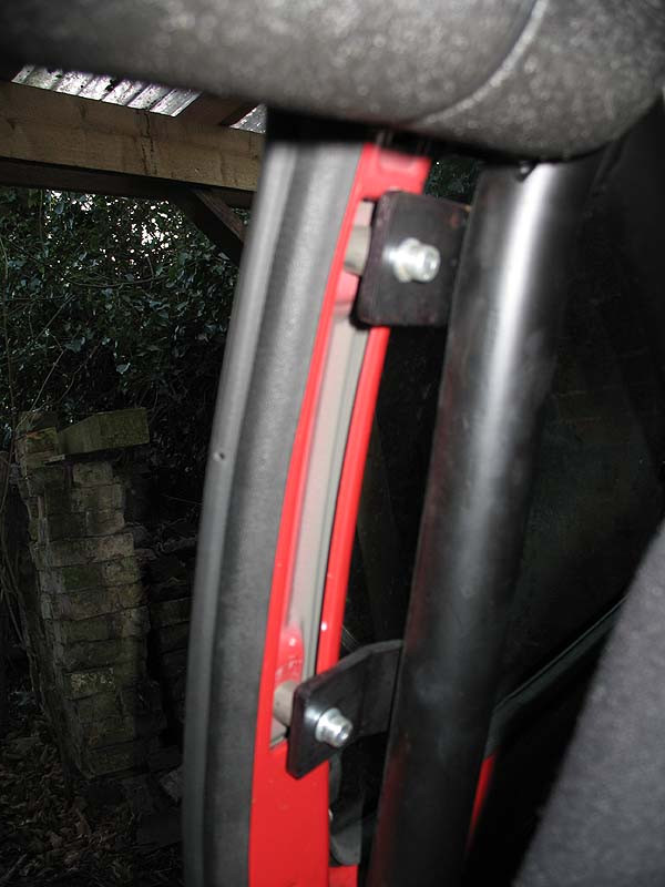

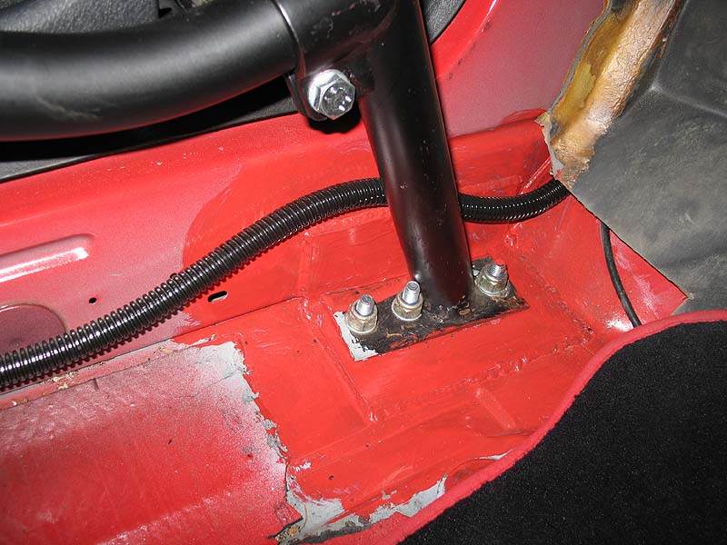

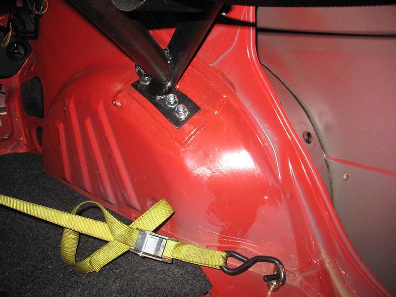

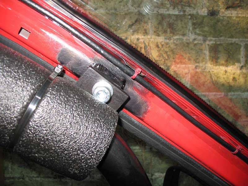

Details of the plates that I made for Safety Devices 6-point cage. The Idea was to spread the load out as much as possible and try to tie in to the structural part of the car, as the floor under the cage feet is very weak. The welding was done by a company called Fabricage, near Cambridge (they specialise in manufacturing and installing custom roll cages).
The rear plates shaped to the profile of the wings.
Extra mount for the a-pillar
Extra mounts for the b-pillar using the seatbelt fixings

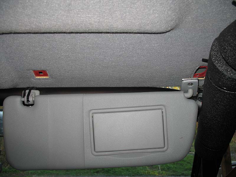

As the sun-visors can�t be used with the cage, made some brackets to keep them

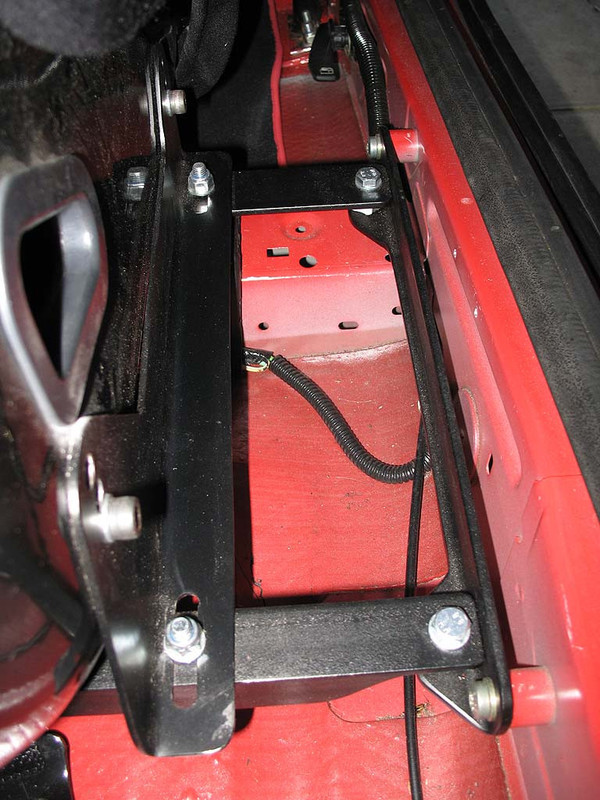

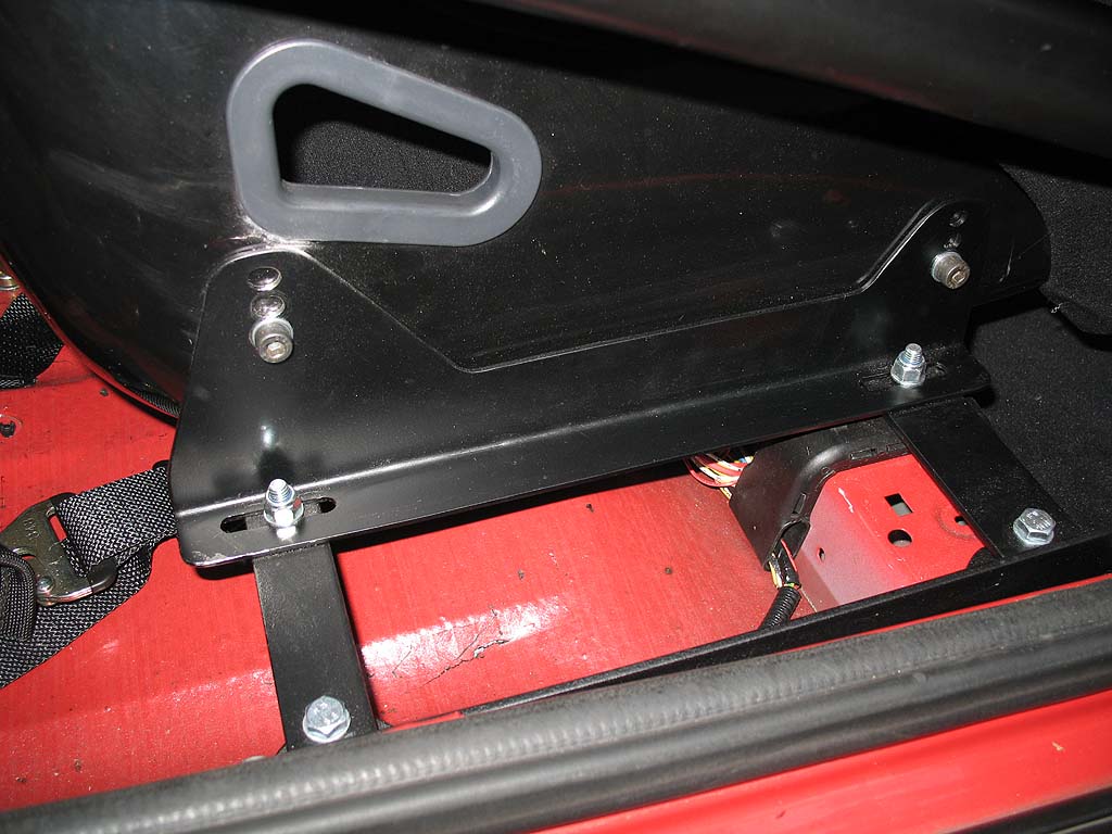

Made some seat subframes to re-use existing standard fixings and lower the seats as much as possible. Not to mention that the driver�s seat is perfectly in-line with the steering wheel (which most people do not think about when fitting bucket seats).

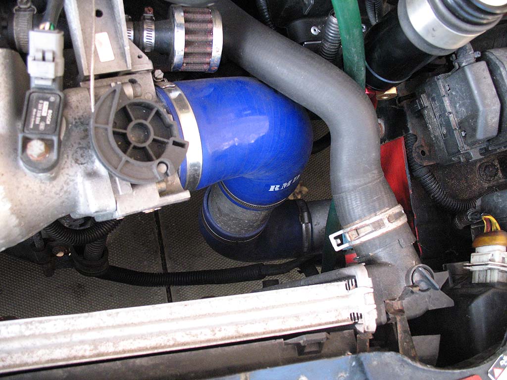

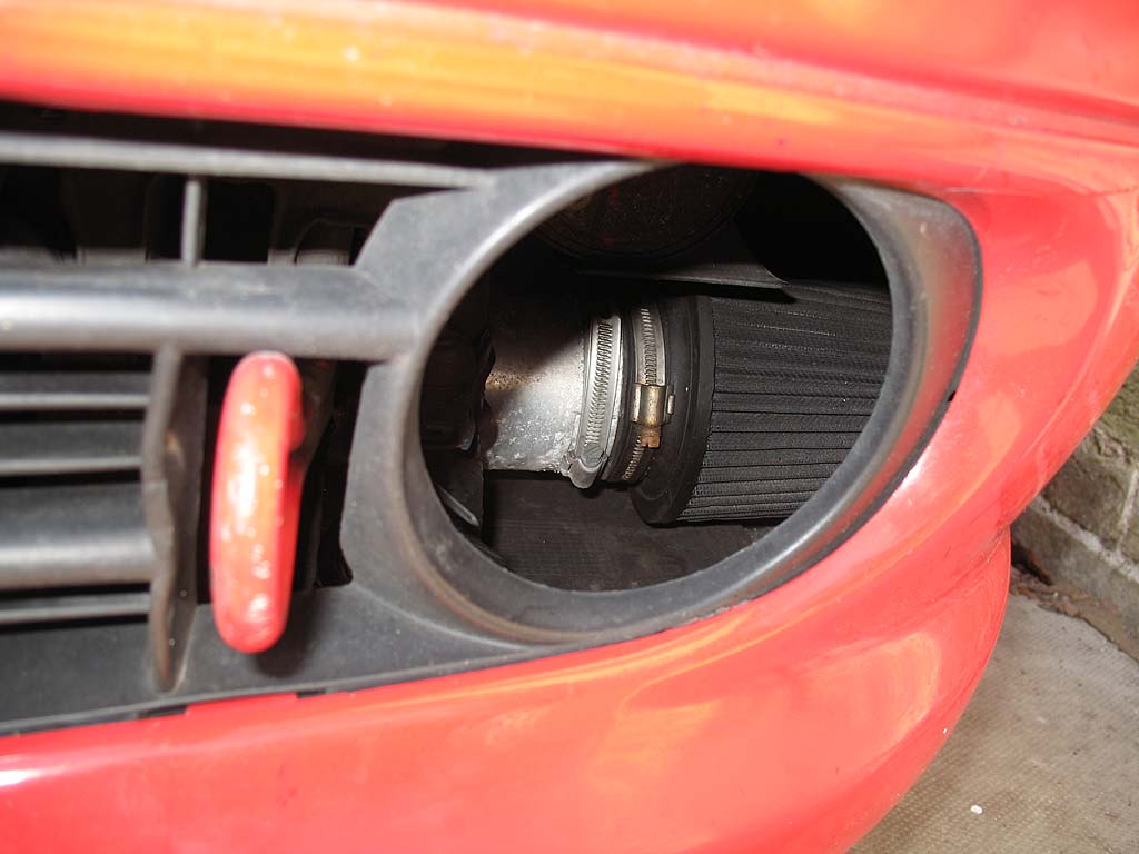

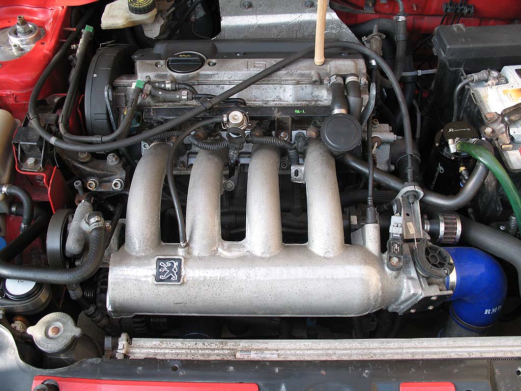

Home-made induction kit. RS engine seems to respond very well to long inlet, so I�ve moved the filter as far away as possible from the throttle body. Rolling road showed some nice results...

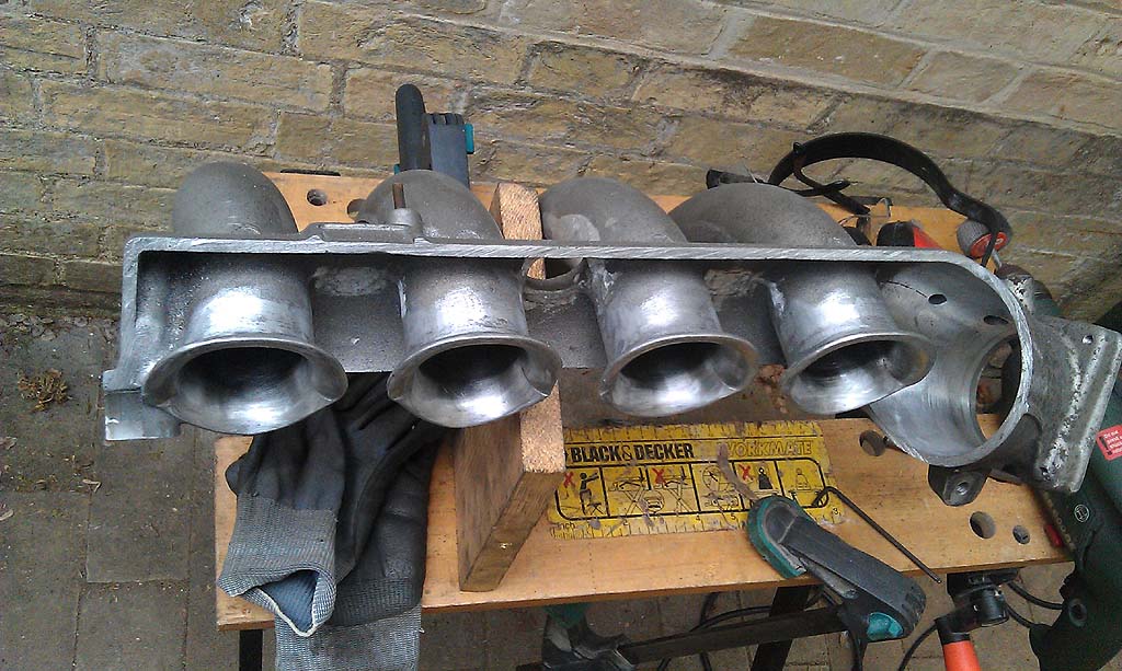

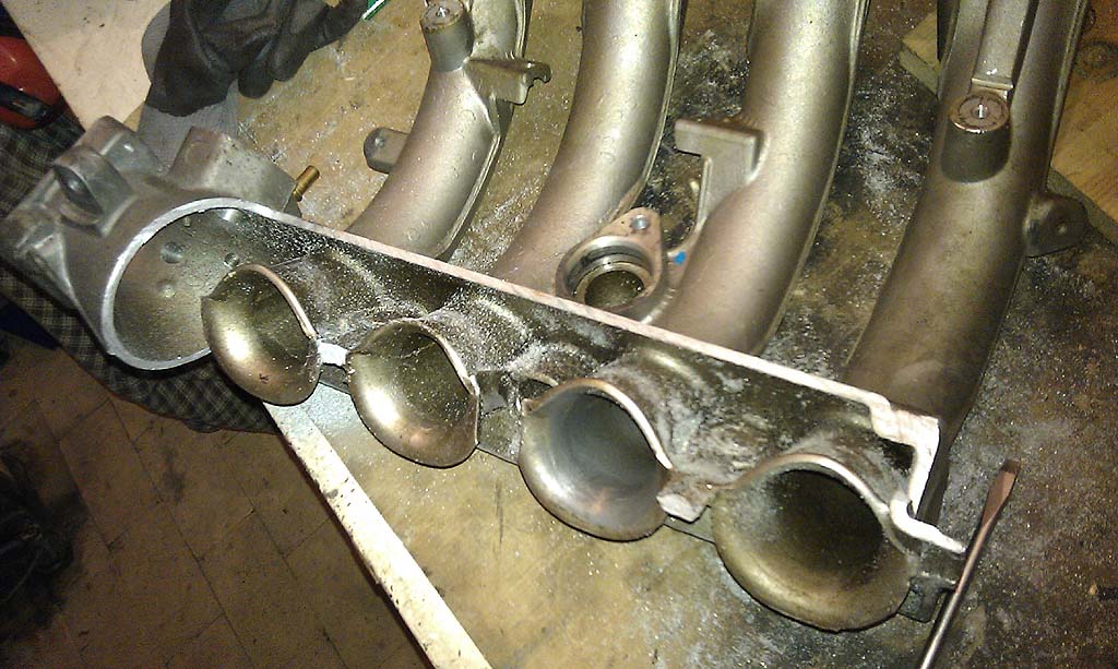

Who cares how the inlet manifold looks on the outside? It is the inside that counts. So cut it open, smooth and polish all the runners and trumpets. Seat dyno says that the engine breathes better at the top end.
Polishing the insides
Welded back up

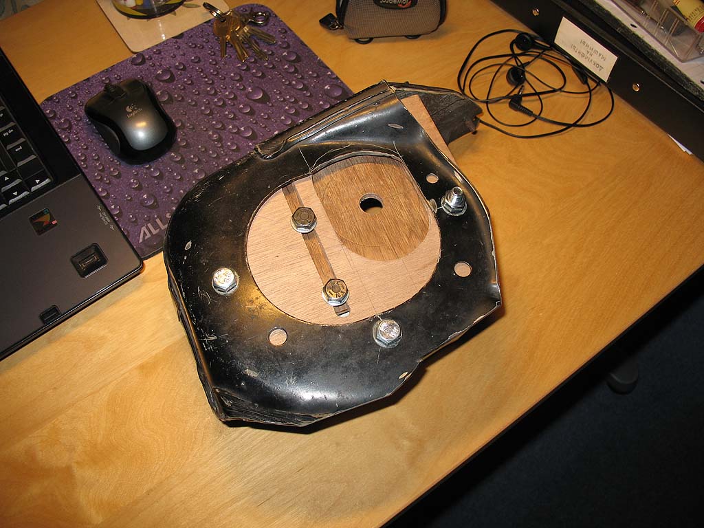

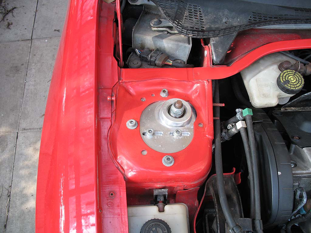

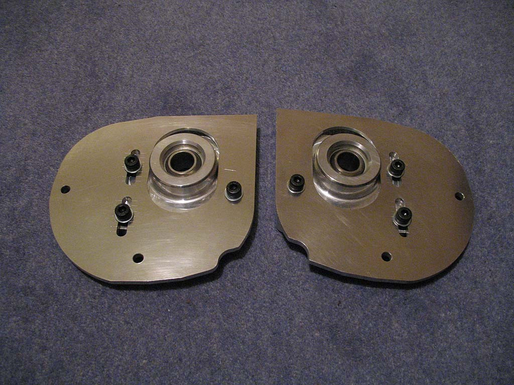

Design of some new top mounts for 2 deg of extra castor and adjustable camber 1 to 4 deg.
Wooden prototype
Freshly made
Plate fitted to the car and metal cut away to give clearance for 3deg of camber (no need to cut anything for 1deg, but anything else needs a bit grinding away)
Finished item set to 2deg

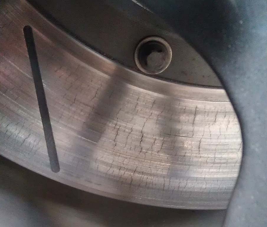

Brake disks cracked from multiple heat-cycles

jeffers wrote:
Denis, them front topmounts are a work of art! How much did they cost to have made in the end? Unsure
They cost quite a bit as 10 sets had to be made to make it economically viable to produce CAD drawings etc. I am just in the process of finalising the list of fittings and getting some prices for a batch of bearings. Once this is all done – will know the final price.
The first set is behaving well on my car. It is surprising how much heavier the steering is with the extra castor!
