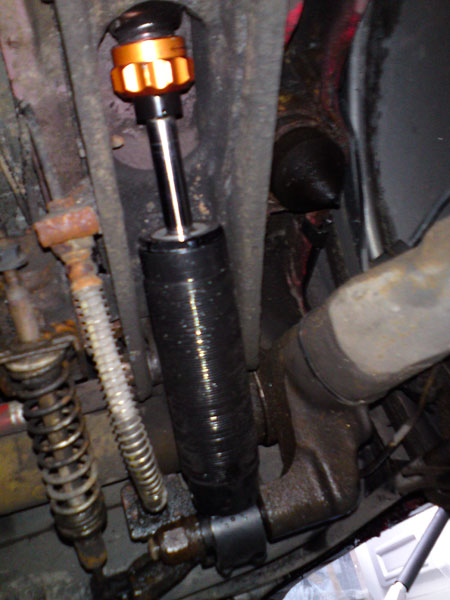

Post #127
Rears now on with new beam mounts. Bloody wishbones had the wrong size ball joints in. They will need to be re-valved as (as curtis suspected) they are too soft even on the hardest setting.
Going back in later this week when i'm not using it to be changed over. Just got to figure out how to make the ARB bolt stop in the trailing arm for more than 10 miles...

Post #128
it just keeps pulling loose. The original ovalled the hole so has been tapped and helicoiled. Yeah will try locking compound, but really need a new beam!

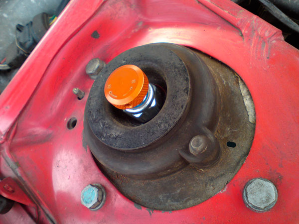

Post #130
Looking very nice Love
What are the materials used for the shaft etc etc, im presuming it wont start corroding after a bath of salty crap in the winter?

Post #131
Looks like ground chro-moly steel with chrome plating from the photo's.

Post #133
Geek Wink
Im guessing that will stand up to most things without corroding then Dunno

Post #135
rallyestyle wrote:
Geek Wink
LOL
Hardened stainless shafts reflect light differently Smile

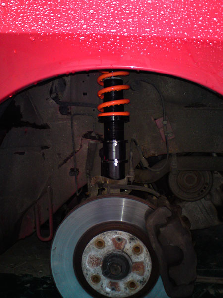

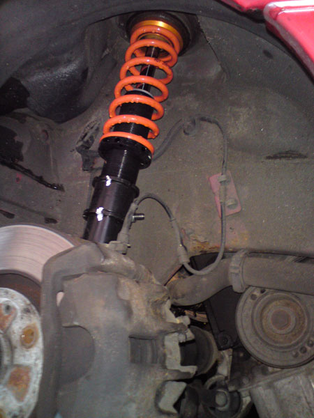

Post #136
front setup feels pretty good from the short passenger ride, only a pootle down the road though, rears need some work as they're a bit bouncy still.

Post #138
A lot bouncy... The grip on smooth roads if I am also being smooth is just astounding.

Post #139
Damping does depend somewhat on driving style, you can get away with less damping in certain areas with a smoother driving style.
That's the only problem with better dampers - you end up with so many different combinations on the amount of damping valves/needles/ports/bleeds that you can have, it takes you 10x longer to dial 'em in.
There's something like 124 million valving combinations on these Foxes, I'd imagine the AST's are much the same!

Post #144
UPDATE: Rears are off again ready to be revalved. Currently have the konis back on until friday on their hardest setting. Slightly too hard for the front imo, but the grip is quite astounding and I'm again gobsmacked by how good the PE2s are in the wet.
