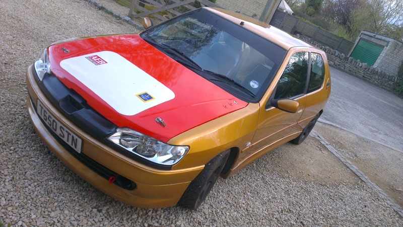

Before Combe yesterday I had a few things left to do. Early track time meant driving down on the R888s. Not massive fun when its 2 degrees outside and maybe too much damping on the rear. Was interesting a couple of times.
So thursday I drove it over to Bicester to pick up a fibreglass bonnet (it will deffo fit mate) from a spaceframe 306 rally car. It needed a fair bit of 'adjusting' to get it on. The tried to bleed the brakes. First bleed nipple was solid on the front. Gave up when it started to round off - needs a 6 sided 10mm. Joy. Didn't matter as it turned out - brakes were fine on both sessions. Will need to be done though.

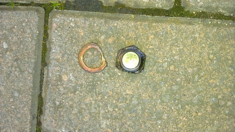

Then turned to dropping the oil. Now regular readers (sorry reader...) will know it was bollock-scrapingly low on the front. The tyres were mullering the arch liners. One small clout on the sump meant this happened to the drain plug:
OMFG. Didn't have a spare so chucked on a new washer and truck on. No drips. Happy days for now.
Here is car before it left on saturday - check the colour matching:
Turned out to be very well planted on track. It doesn't have much welly to get past some cars, but doesn't half carry speed well. Very composed if you have to snatch a gear mid-corner too. Ahem.
First session I was only overtaken by a S14 which then held me up as his tyres went south. Took 8 cars though. Second wasn't so great and I got held up a lot more by a prick in a 'track' Ibiza. Wouldn't ceed position even when I was in front by a few feet into Tower. Outbraked him. Had a lot of that tbh, but then it was an action day, so glad to get home in one piece.
