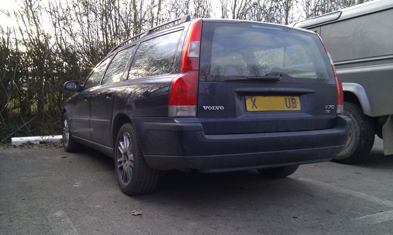

I love my brick Love
I couldn't be arsed to move it out to take a photo of the front or clean it. Obviously. You know it really does just look like a dark blue volvo V70 Wink
And I would have taken photos of the parts going on, but they weren't that exciting either. Just have to wait for its first trackday and a few slidey-slidey ones Smile

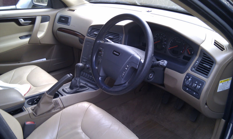

SE spec, with the Dolby stereo is it?
The missus and I are still after the D5, albeit with black leather if we can help it!
How do you find it on fuel by the way?
Posted 29th Jan 2011 at 03:08
Guess it must be SE spec and its got the mid-range 9 speaker stereo with HU803 unit with dolby. No sub, but still sounds awesome (really punchy bass). I was after black leather too, but I have to say its nice having a light interior for a change. Like it a lot more than I thought I was going to.
