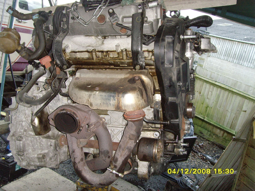

Right I'm going to attempt to make one of these
Can anybody advise me what gauge to use? found a decent supplier in the states but unsure what gauge to useDunno

Mate I've got 16 years fabrication/ welding behind me. I have welded everything from tin foil to Ocean going tanker hulls. I am very confident I could do it but I am also aware that it's not a job taken lightly unless you have access to a workshop with the right tools.
But fair play to you if your going to give it a go. Hope your a patient man.

I totaled up 56 hours of hacksawing, grinding, filing and tacking, to get my manifold done, plus the time it took a friend of mine to weld it all together.
It can be done, be patient!.

No pistons available so it's going to be decompression plates, the original manifolds are cast, not sure if the rest is mild steel or stainless but would rather just to the whole thing from scratch tbh

original manifolds are cast, so a no go there.
anything is possible regarding the pistons, just supply a drawing to a company that makes pistons!
DP engineering made 317 bhp on stock engine for 6 years now.
you introduce many complications if you use decompression plates, your inlet manifold wont fit for a start!

never seen one up close but DP-Engineering have that manifold pictured in a 406.
main costs are the time to make the manifold and the turbo itself, and an ecu to run it, specifically converting to a V6 doesn't cost that much if you diy it.

I have no experience with v6 engines but could you not use the original manifolds and send the down pipes to a remotely mounted turbo? The one pictured appears to do that or an I missing something?

it could be done very easily yes, I think its just that the standard D8 manifolds are perceived to be a bit restrictive, but they clamp to some easily adaptable V-band style clamps before joining the link pipe then the downpipe itself.
