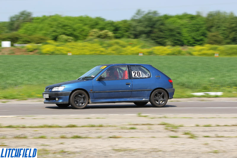

So many, many things have happened. Over the winter the interior was further worked on with plumbed and hand-held extinguishers installed, ally nav foot rest, re-painting, removed another load of wiring loom, new dash board with better (still a bit dodgy) flocking etc. Also WP built a 4.4 5 speed hybrid box and it had a quaife chucked in for good measure. Since then its gone back to a 6 speed whilst an even shorter box is being sourced.
I changed wheels to direct fit MO5s (still 15"Wink as they are bombproof and then managed to squeeze these over my old set of Pendulum MS 310mm RS Brembos that I bought back from Brendan (with a 10mm spacer). These run DS2500 pads and have been awesome. Its also had a set of piper 270 cams and we replaced 3x stuck lifters (it needs another doing). And its had an oil cooler.
I have also wrapped it white using avery vinyl and installed a TRS carbon roof scoop.
Its done 3x sprints (Pembray, Combe and Blyton), spring action day and a Combe track day. I came third at Blyton (on Motors TV!!) but was beaten by considerably faster stuff, Atoms etc, at the other tracks. I'm still massively impressed by what I can beat though - evos, imprezas, clios, various bmw track cars. I'm trying to get another track day in before winter (last two rounds of sprinting were out due to family stuff).

I've recently gone for another pair of AD08R for the front. I cannot say enough good things about them, especially as they are so blinking cheap and do 5k miles (with 300+ miles of track).
Otherwise over the winter i'm going to finally finish and fit the FG tailgate I bought from Twangy and possibly fit the good beam I have sat in my £78 Meridian spare parts car. I also need to sort a few water leaks and in an ideal world I'd get a non-sunroof roof skin into it. At the moment it is my daily driver so I can't do a great deal.
I'm also on the lookout for a 3rd/4th cluster for a BE4 from say a 206 petrol to build up the partner 4.53 FD i've got for next year. I think I need to find a better series to sprint in as there is little point trying to beat s/c atoms and turbo dax rushes...
