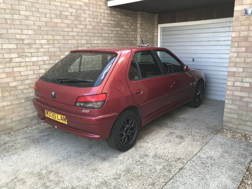

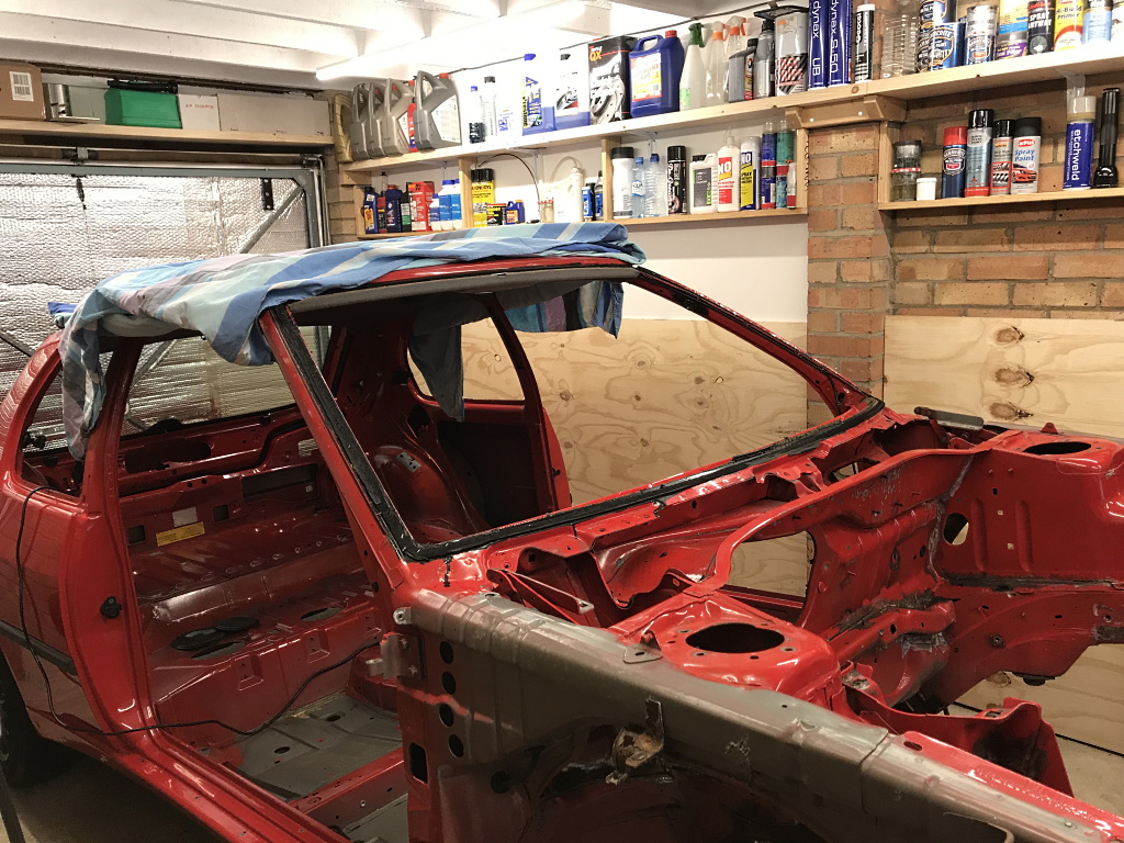

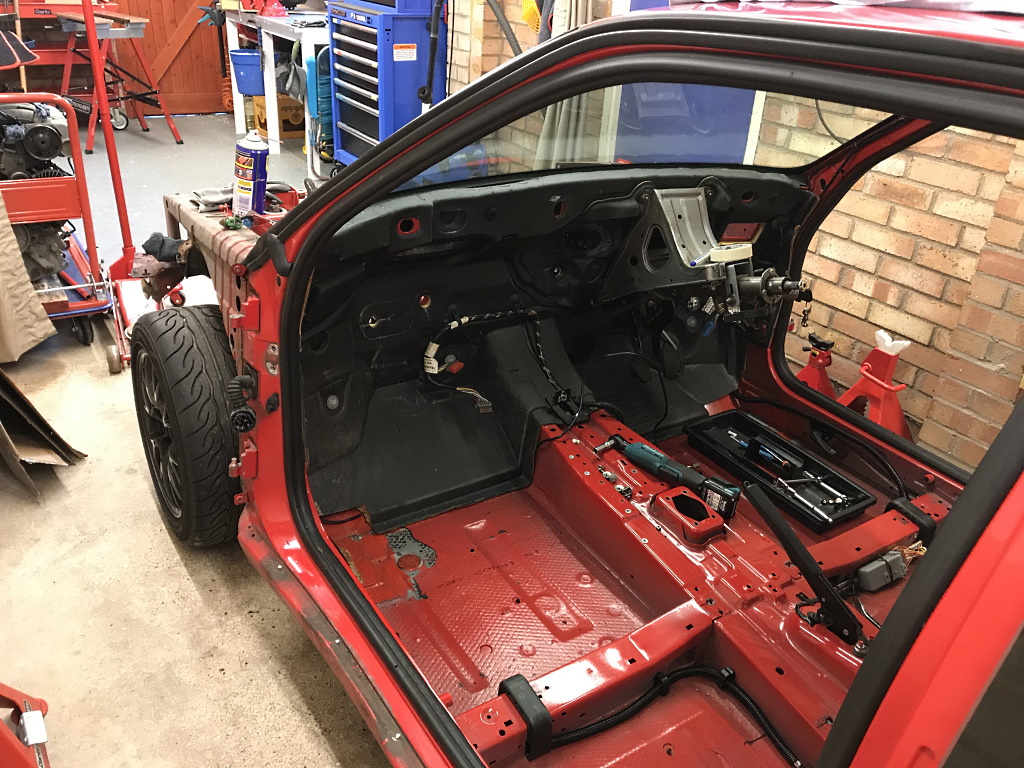

Even though the car looked good in photos – up close it was very different: plenty of dents and scratches. Lacquer started to lift on the roof with the roof turning pink.
Also, with plenty of rust on the underside – I have decided to tidy up the bodywork Yes
Started with taking the engine out to get full access to the engine bay

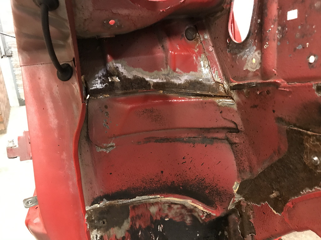

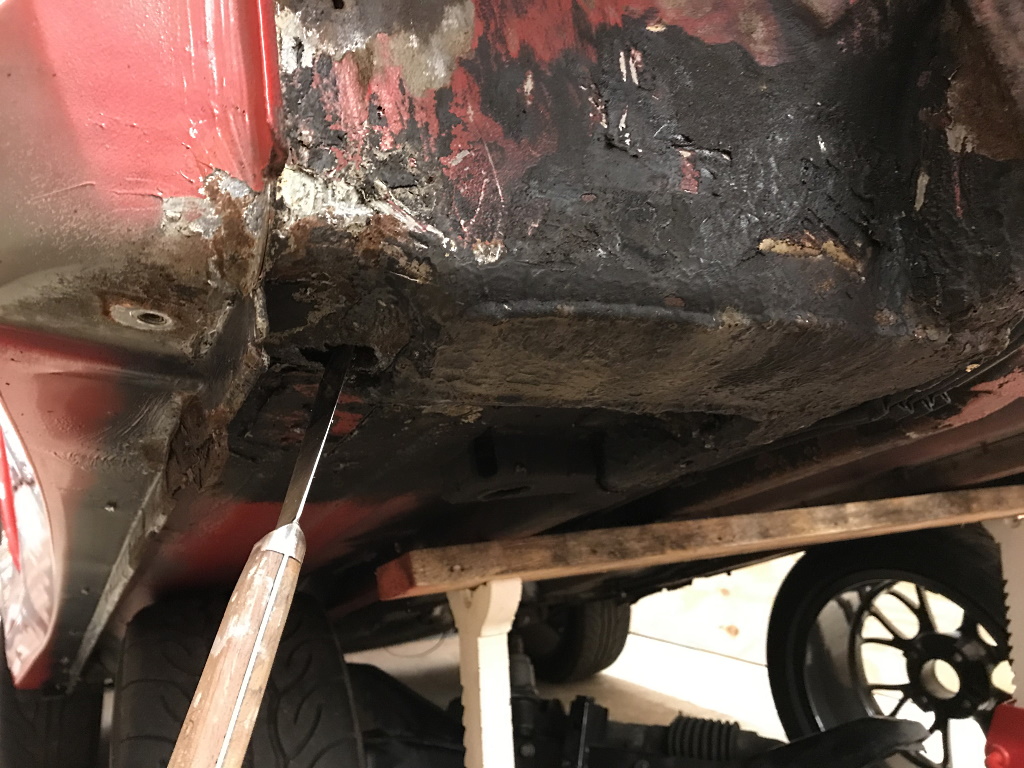

While pocking under the driver’s side wheel arche – found several rust holes, including in to the cabin, so dashboard had to come out
Cherry Red Rallye Project thread

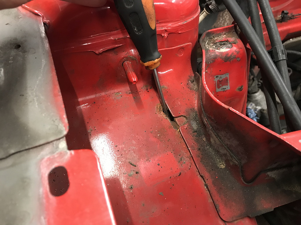

Post #203

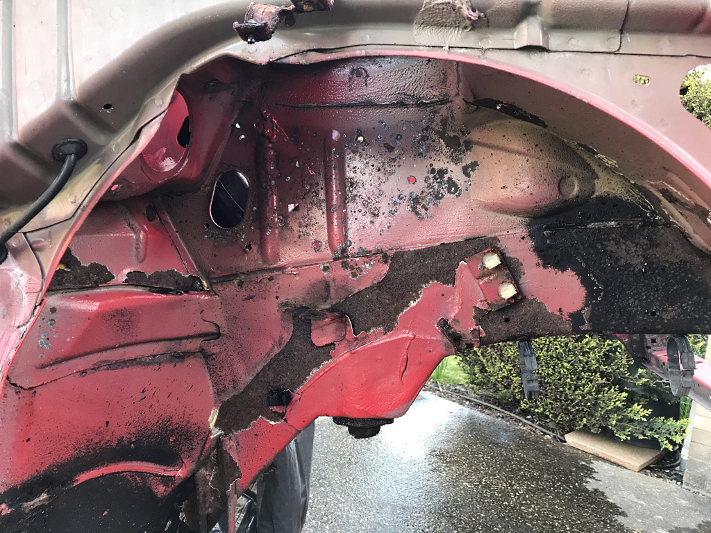

Jet washing the front end showed lots of rust on the driver’s side chassis rail. As the passenger side rail had some damage (due to hitting a barrier at Croft a while back) – I started investigating options on what to do. Having looked at several 3dr cars – all of them had rust issues. I came across a really clean 5dr shell that was a suitable donor Smile

Decision was to replace rusted metal, so I carried on taking things off from Rallye.
Windscreen came out (first time I attempted to cut one out).

Sound deadening out. After trying various methods – the best one was to heat it up with hot air gun and it just pealed off in large pieces.

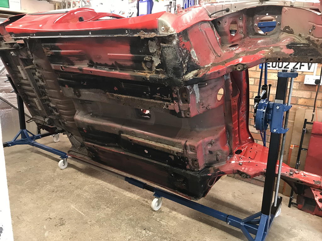

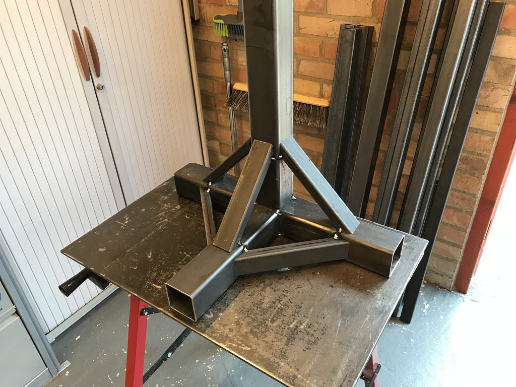

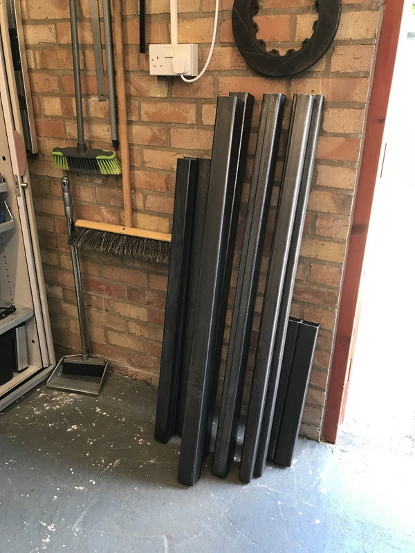

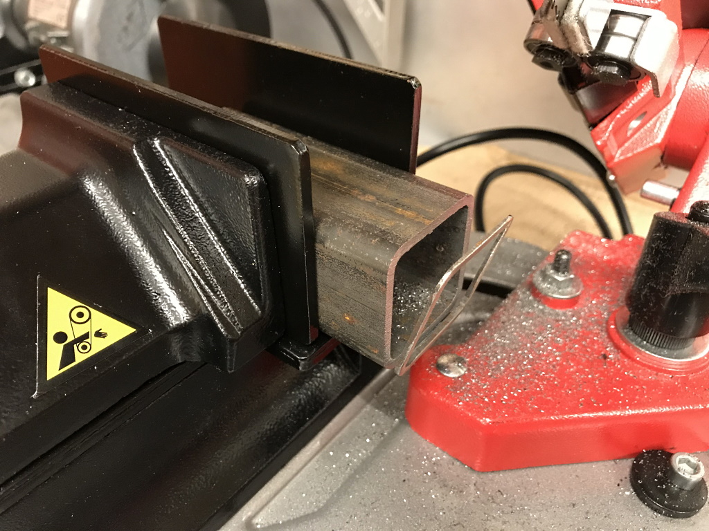

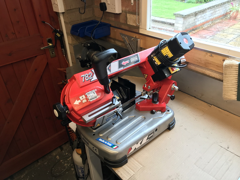

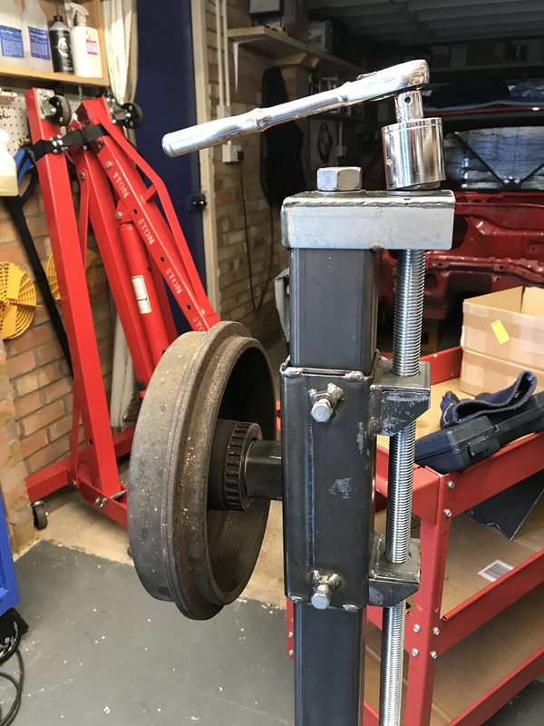

The next step was to make it easy to get to the underside of the car. Having looked at what rotisseries were available (proper ones = too expensive, e-bay ones = not well made), I decided to build my own.
A good excuse to buy some more tools

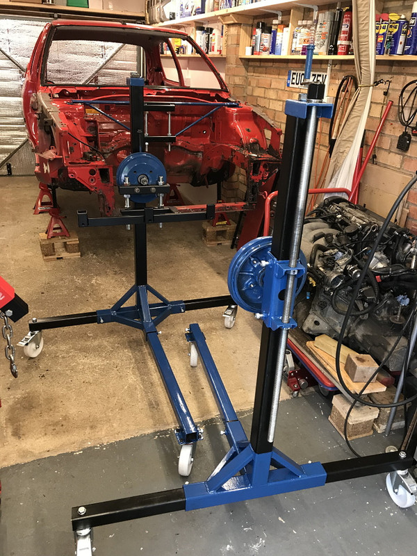

Post #207
Some self-assembly required

Post #208
Mock-up

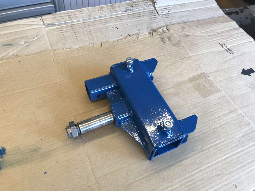

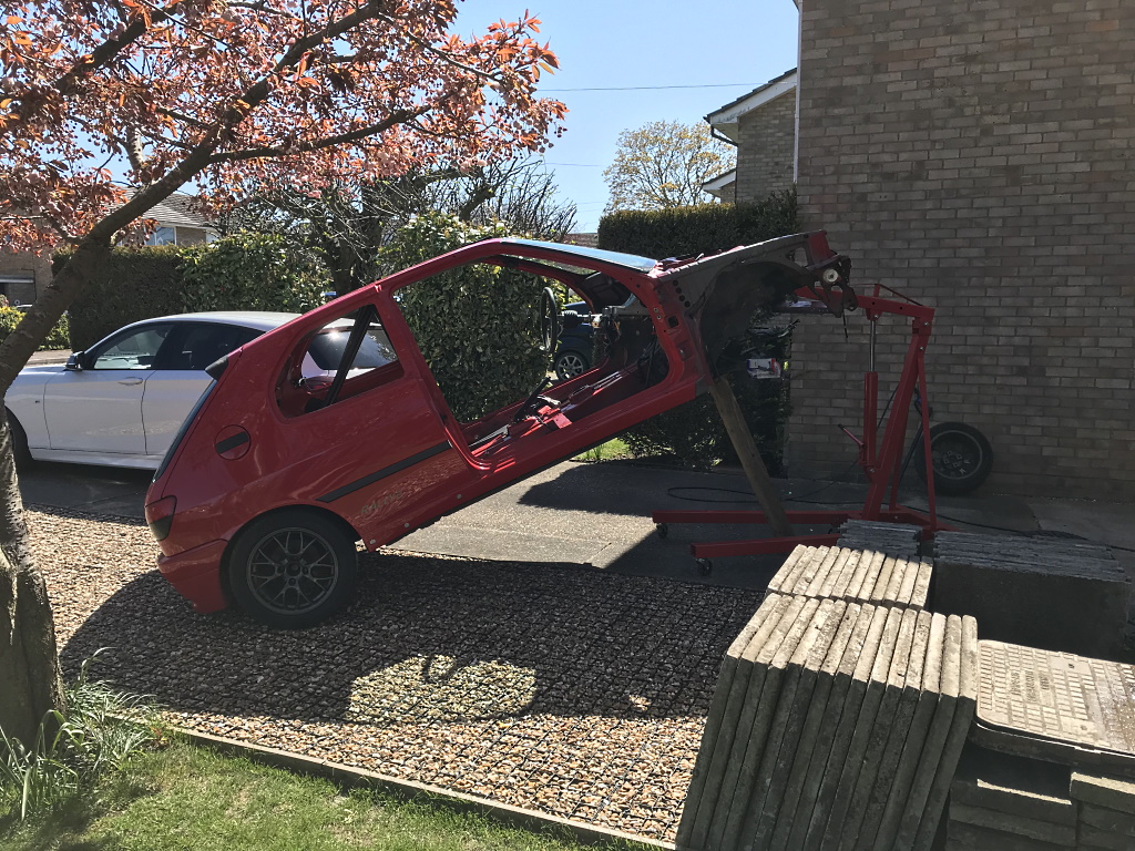

Post #209

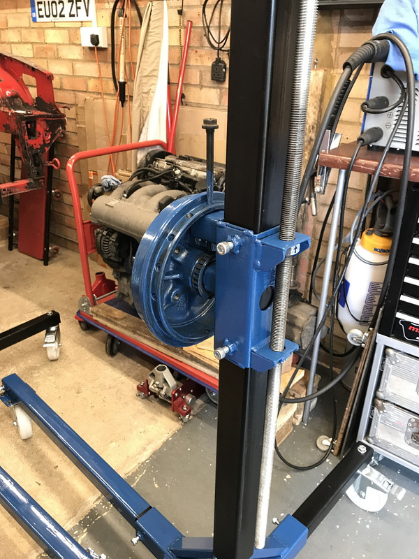

Lifting mechanism, so that you can pick up the shell from axle stands and lift it to any hight (allowing it to spin 360deg). Used rear hubs from the donor 306 to make the pivots.

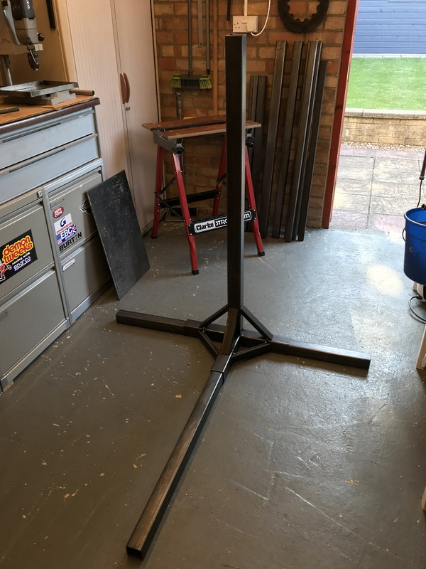

Post #210

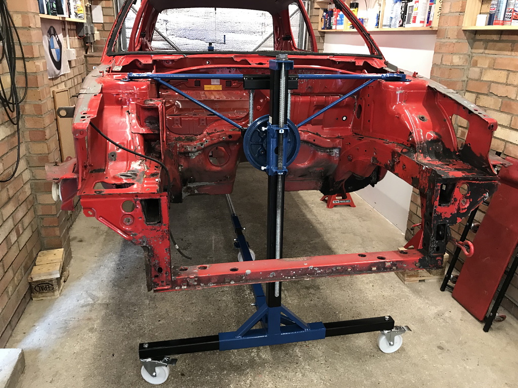

A bit of paint transformed it!
Complete mechanism with the ability to lock rotation (brake drums drilled for locking pin)

Post #211

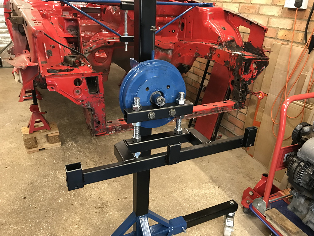

Made several attachments for the front: for strut tops and for bumper attachments (you’ll see later why).
(more to come)

Post #212
Proper job this.
I've the same issues regarding the rust. Managed to patch up where I can to keep it going but at some point I'll have to bite the bullet and go along these lines.
Keep us updated as its great seeing the progress.
