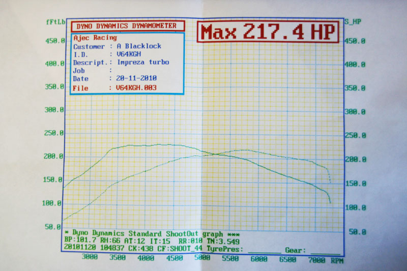

Nope. Not great. Massive overfueling. Probably mullered the pressure regulator by putting on the walbro. Got 218bhp and 225 lbft at the fly. Going to change the fpr to an adjustable one to cope with the pump and take it from there as it could also be a sensor...

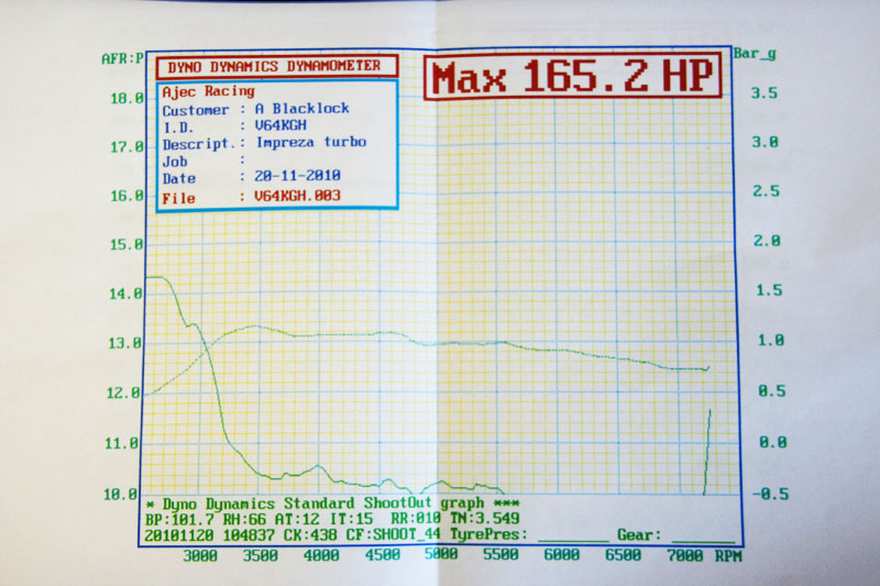

Spot the problem LOL

slightly rich but nothing too bad until 5500 rpm. Then its just retarded. Why does it over fuel so much>?

Changed the fuel pump to a walbro 255 and I have a feeling its over-powering the fuel pressure regulator. Quite a common problem as the standard fuel pumps and regulators aren't very strong. Have an adjustable one coming soon. Not much point going back to the old one as I think it was underfueling.
Could also be lambda, coolant temp sensor and a sticking injector.
Posted 22nd Nov 2010 at 17:02
Post #35
looks like it only goes silly rich when it comes on boost Hmm
Shouldn't be lambda, as its disregarded on WOT by the ECU.
Posted 22nd Nov 2010 at 17:03

Unless it's a wideband there'd be no point, it wouldn't be accurate enough to make changes to the fuelling under WOT.
Haven't disturbed any of the turbo pipework whilst fitting it have you? Looks like it could be a boost leak Hmm

I don't think so. It's a pretty small turbo and dies on its arse top end. A long way from something like the p1. Will go over it again though tomorrow. Dump valve might be playing silly burgers too.

After a bit of a cold nightmare doing the FPR its now Superman

We've had it back on Ajec's RR today and adjusted the fuelling whilst it was on the road.
The final figures don't tell the entire tale as usual. Its holding on to power and torque loads longer now, although I seem to have an issue with it sometimes backing off the boost and fuel, always in the same place. Probably the boost solenoid cocking about again.
Anyway so far so good - 238.7BHp and looks like 235lbft. Think the non-prodrive backbox might be hurting the torque.
