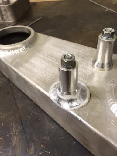

Anyway, nice tap fit bosses with seals for the pump casing, and there's a Lexan cover to be sealed over the front so we can inspect the belt without having to break any seals if not required:

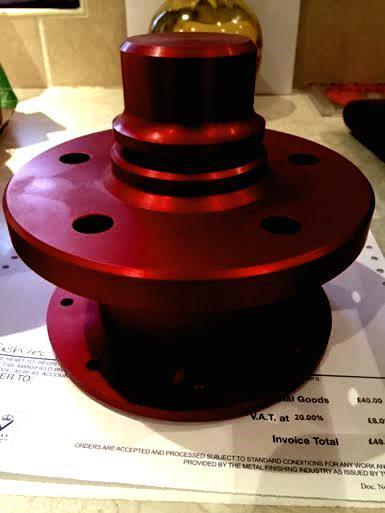

Rear hubs got anodised for corrosion protection, being in the s**t all the time at the ends of the arms:
And back together:

Wasn't too bad that lot was about 50-60 IIRC, both sides, plus some pulleys, etc for wear resistance.
