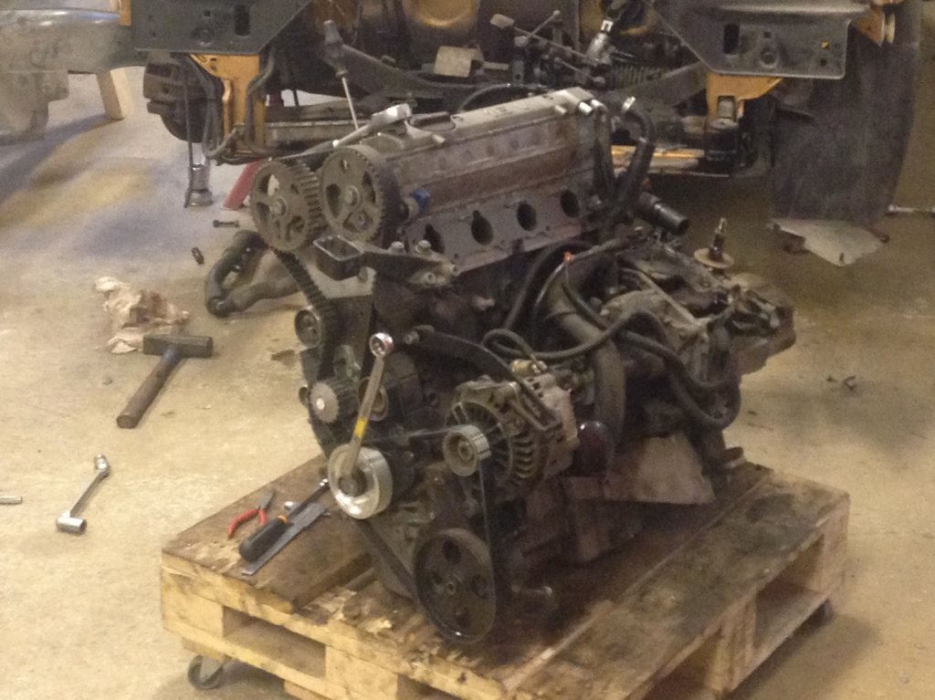

I've relocated the OEM pas pump with some OEM mount. I dont recall what i used but it fit perfectly where the AC compressor was located.
I still use the original pipes, no modification done.
