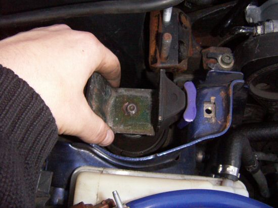

The purple poly block, where do you get them from? Also what are they called?
Thanks Smile

It's just a packer for the engine mount, I cant remember who makes them.

My tip is go to a local welding place, jack up engine, take mount out and ask them to weld in two little packing pieces.
Or you can just bend that piece with the buffers so it goes wider

Rear beam tensioning kit by powerflex.
Ahh brilliant, cheers.

I would advise you to put a screw through the purple mount in order to make it stick to the original mount. As i had put one in that place by thinking it would stay there. 10kms later i realized it was gone :dry
I did this, easy as peas and works well.

i made some out of some 5mm ally plate ages ago, seemed to do the trick

as above i welded in some plate either side

I bought some from Powerflex and whacked them on, helps loads Big grin
Only problem is now we found the gearbox mount has gone too Sad
Fingers crossed I get it fixed by Friday night.
