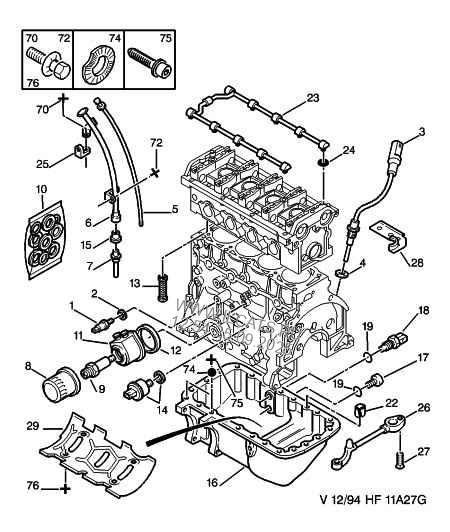

Anyone have a part number for number 10, looks to be 1103F7 but doesn't seem to be right as the outlets on a F7 are straight up and the one on my car 90's out towards the rad, found another one 1103J2 it looks right but no reference to say it will fit,
or does by any chance anyone have one the don't need that is in good usable condition,
Thanks

The drip on my one has got worse so I'll need to replace it sooner rather than later. The 1103J2 part is only 37mm thick, think the one on our cars are almost twice that.
The one's from the DW10 engines look right but don't have the 90deg pipe fittings.

dont go by the pictures, they aren't always correct.
engine in the image is an S16 though..
True. Part number is correct for the XU10J4RS though.
The one from a Citroen C5 V6 might work. Looks thick enough & the pipe connectors are at 90degs. Part
1103H6
