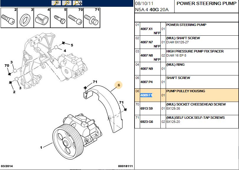

I handily had a spare power steering pump in my car when the bearing in mine failed. i drove to my girlfriends on the battery then phoned the AA next day as had no tools on me. The AA man fitted it but the belt ran one rib out. I've since found that he missed out item 3 and don't know if item 4 in the diagram below has been fitted. Also he broke the cover.
Can someone send me a full set of fixings?
Also, has anyone got spare fixings for the power steerring ram and has anyone managed to recondition one?

I can see the diagram fine.
#3 is an 8mm thick spacer for the lateral location, hole for an M8 screw through it, #5 should still be there as it wouldn't have fallen out.
possible the spacers are sat in the engine mounting, have a fish about with a magnet-on-a-stick.
yup, took my cast mounting off the front of the engine recently and found 'extra' things in there like washers and cam cover bolts. Quite the little collector of random bits....which is probably where your spacers are!
