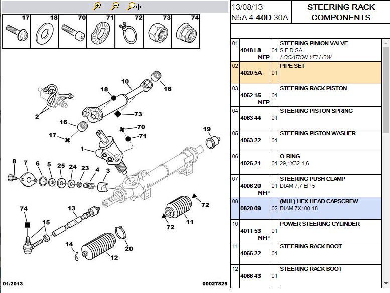

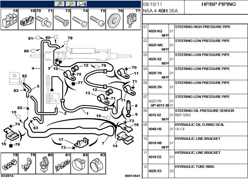

Which of these pipes are the short links:

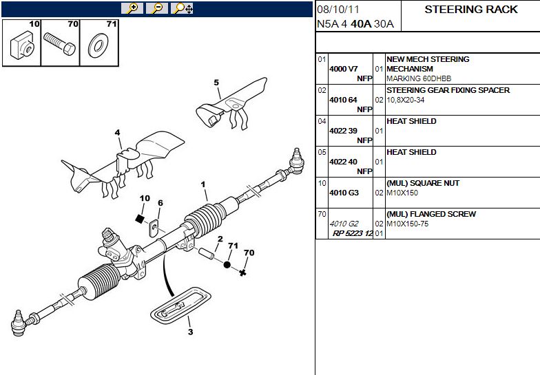

Pretty sure there on the picture of the rack buddy, they come as a pair and was around £110 for 3 pairs.
They're not on here:
Any idea which on the first diagram I posted and will you sell a pair?
Is it part number 2 on here:

Yes part number 2 :-) I would rather not sell a pair as I bought them as spares for my cars. Pretty sure miles sells them though if main dealers don't have anymore.
