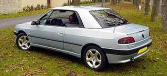

Today, I already measured the actual dimension from actual car and compared the Gti 6 with Cabbie spec. Unfortunately that the cabbie wheelbase is shorter than GTi 6 model for 40 mm. the Doors are same dimension with GTi6 (Some of interior part can be swap with GTI6)
But the length of quarter side panel from the rear end of side door to rear wheelhouse were a little shorter (I'm not sure how much...)
So, Finally I already got all of Phase 3 Moulding from the another Breaking Gti-6. So lucky !
The Moulding is the blue and red in the picture.
