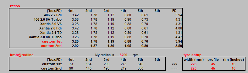

Hi, wonder if I can pass 8K RPM with standard springs and hydro lifters. I need to go over 8.2 to pass 100-200 km/h without shifting. Smile

not advisable, power drops off after 6500 so ahifting would be faster, before considering that the hydraulic tappets do not work so well beyond 7800 regularly
ise a bigger tyre or longer final drive if you need to, thats a weird thing to need though

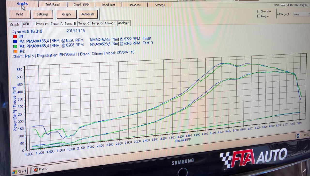

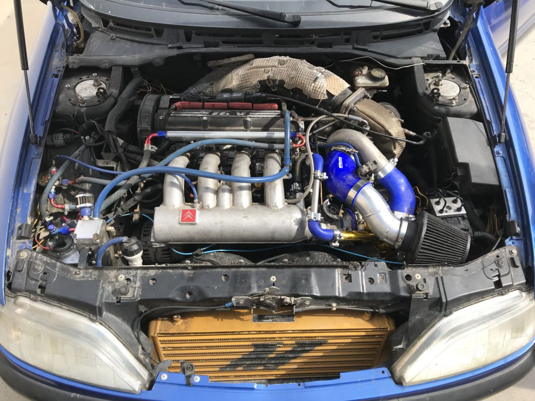

With my old setup the power drops after 7 200 rpm. I am installing cams with more lift, bigger turbo, ARP studs, Cometic gasket and more boost combined with water-methanol.
My ML5 gearbox is with the longest FD from 2.2 HDi. And biggest possible tyres.
