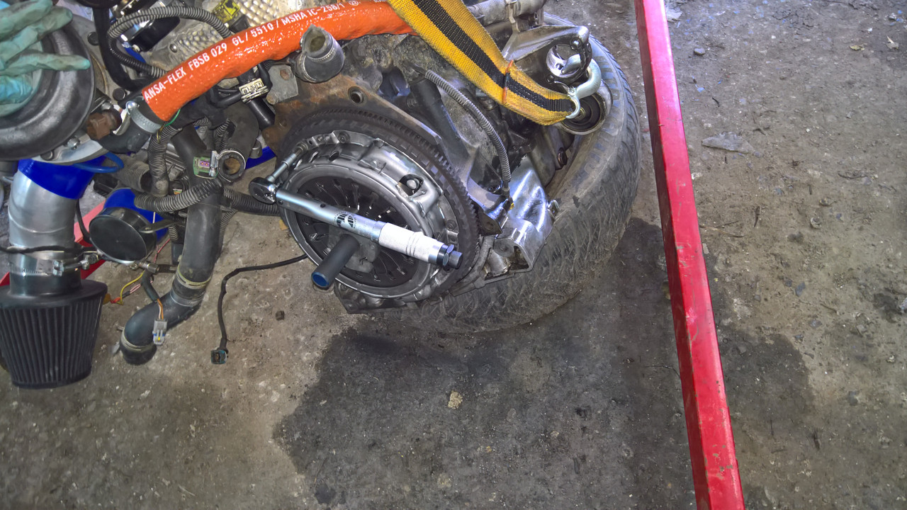

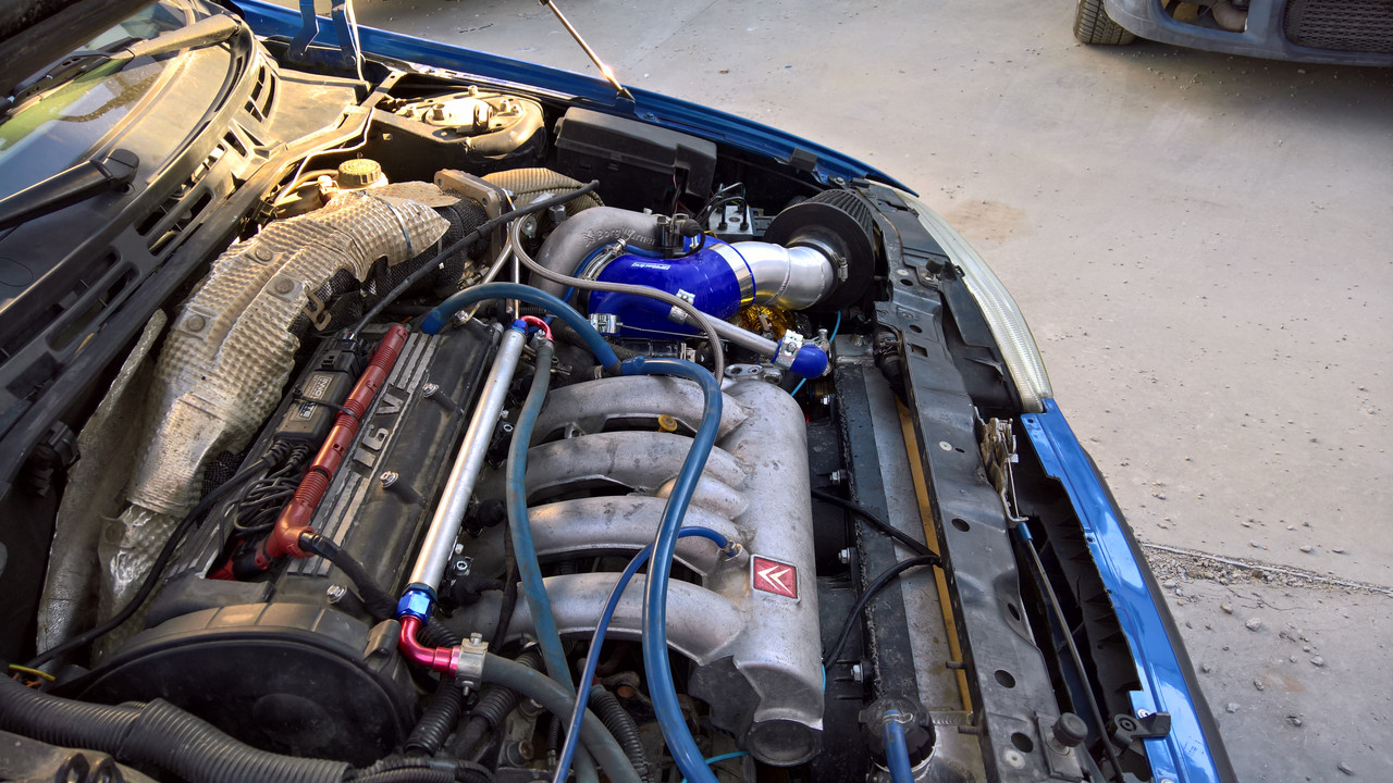

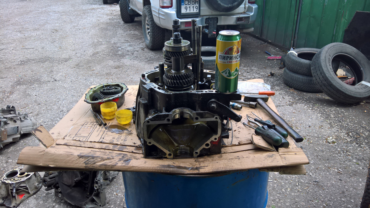

Post #170

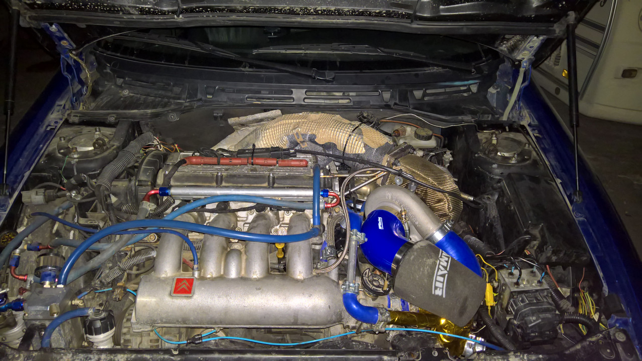

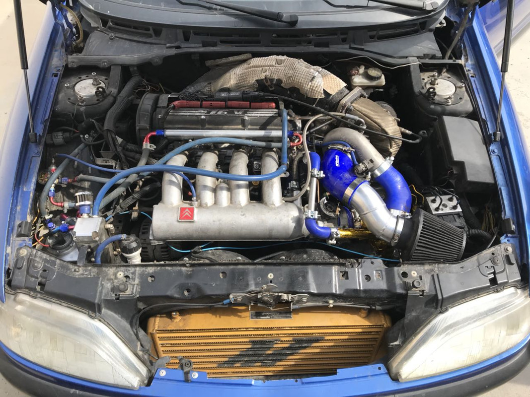

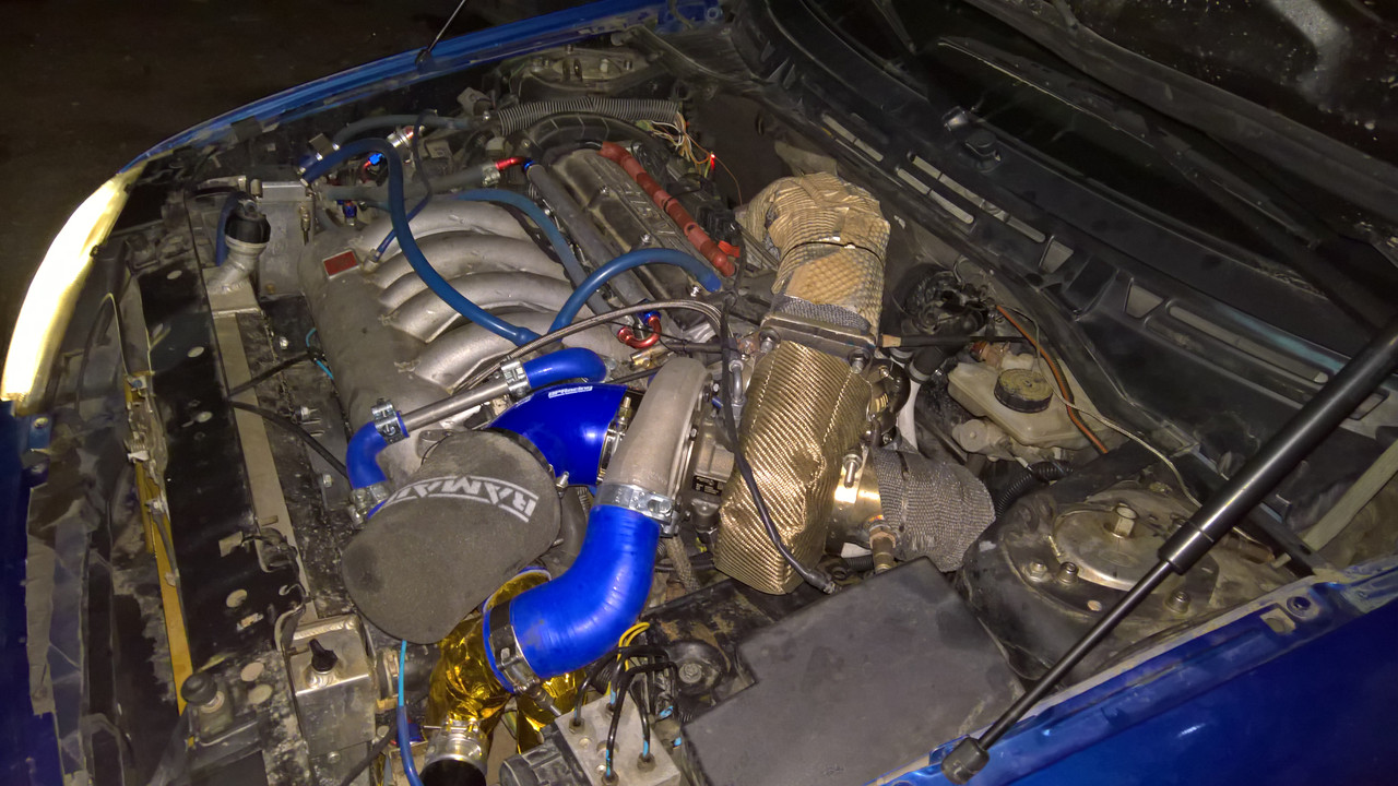

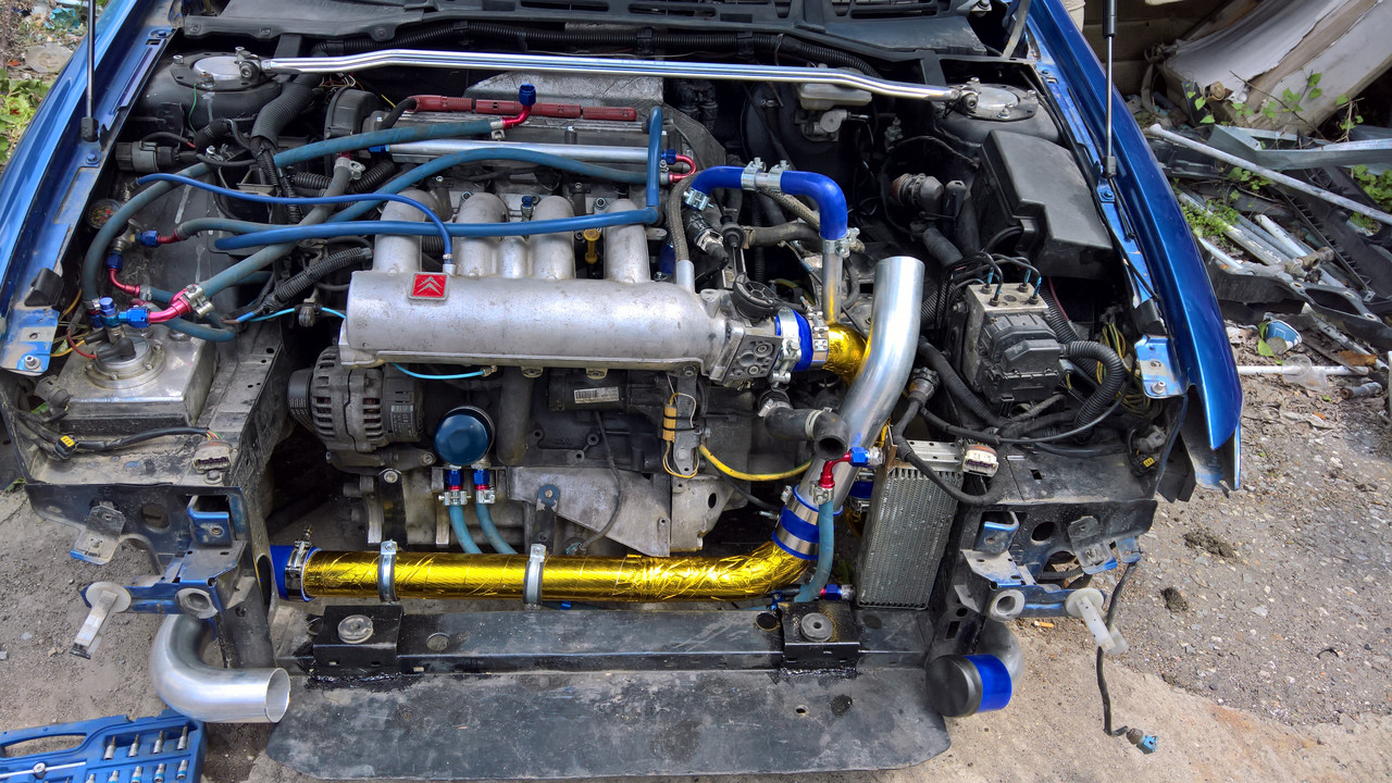

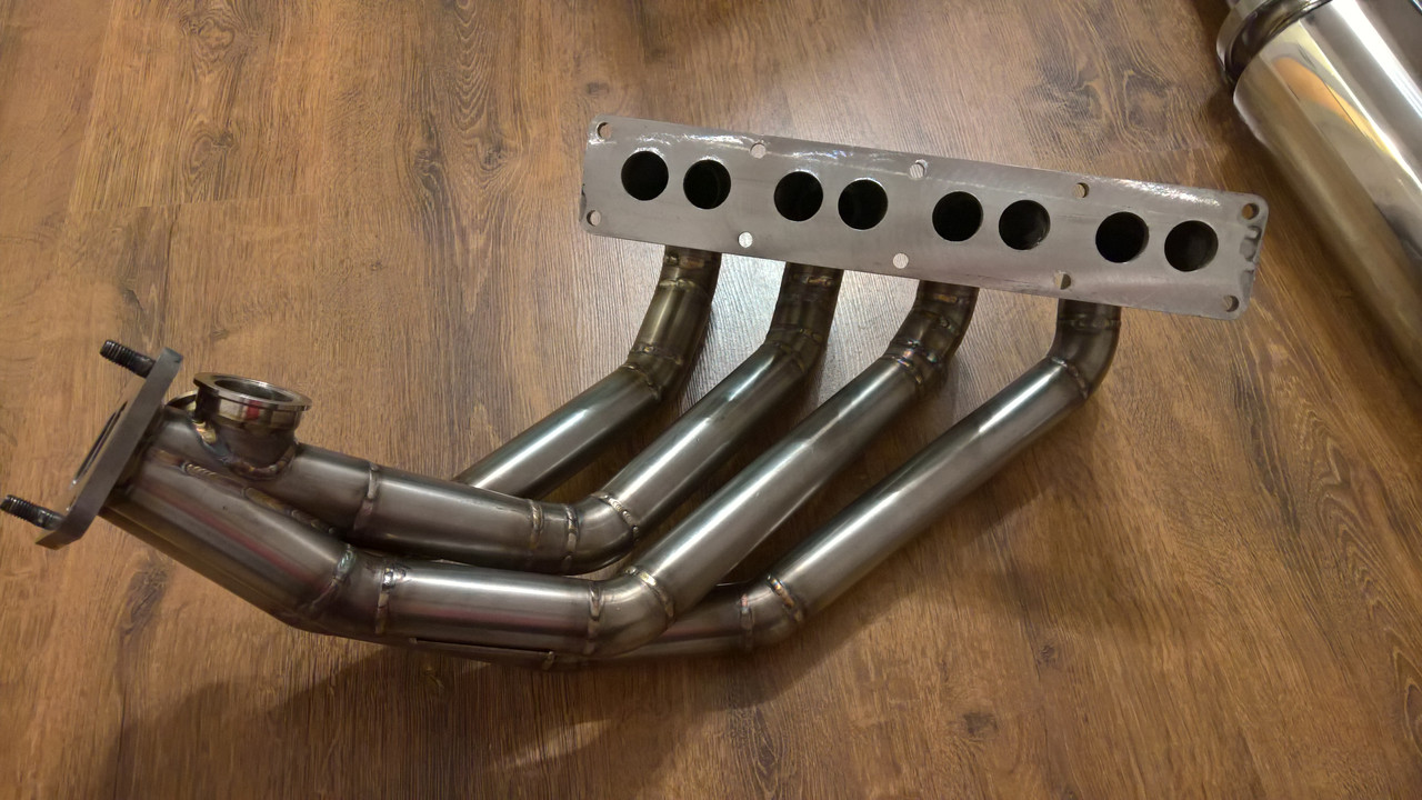

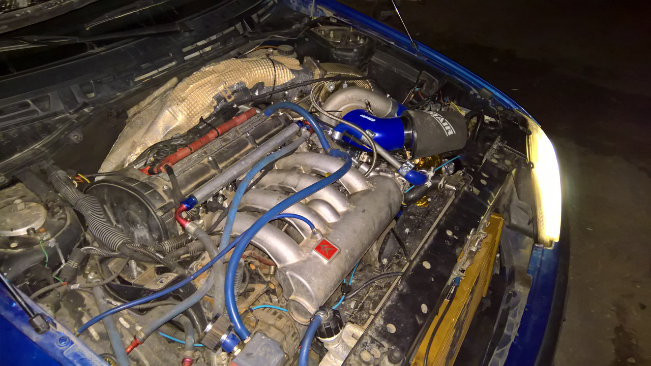

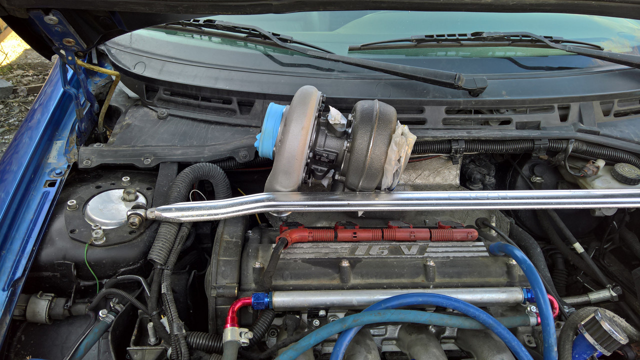

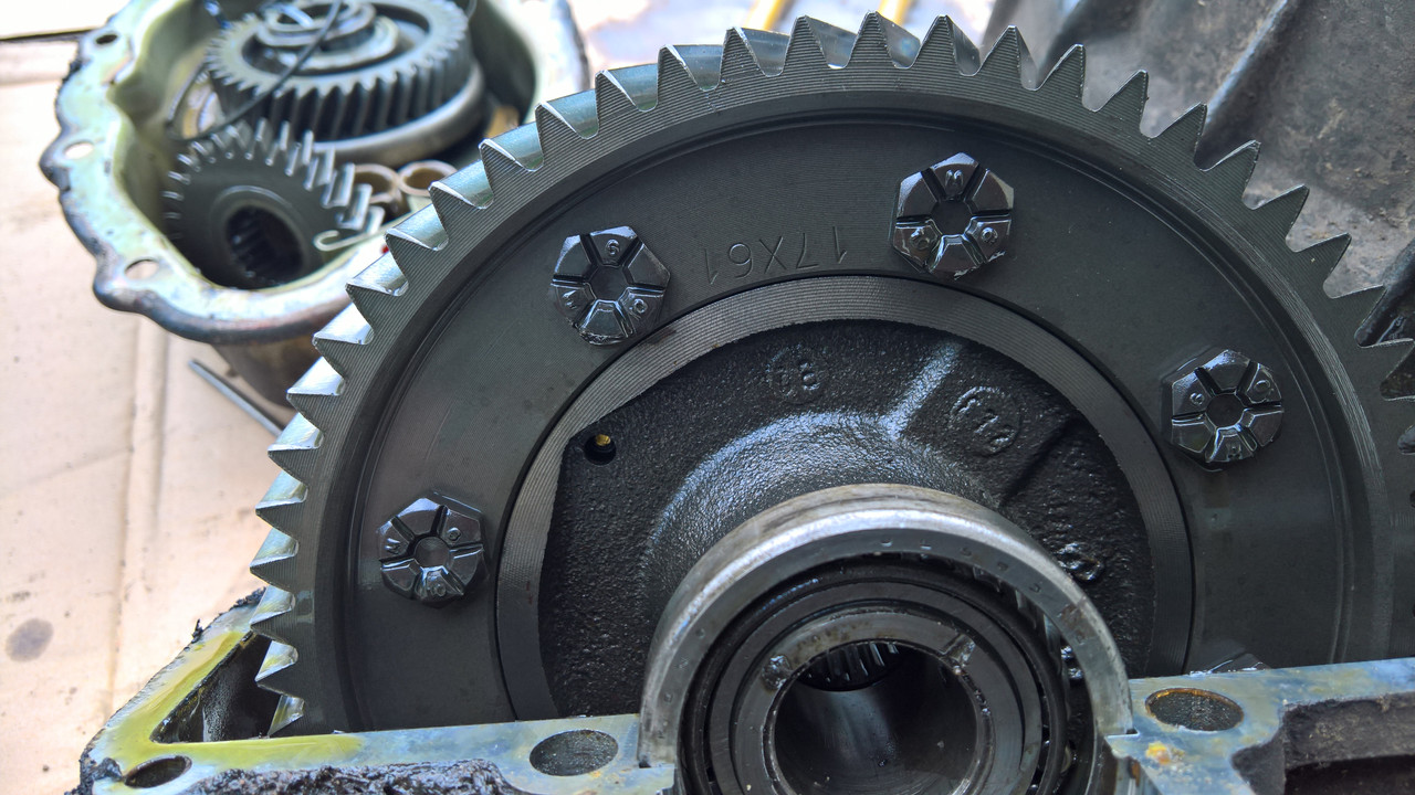

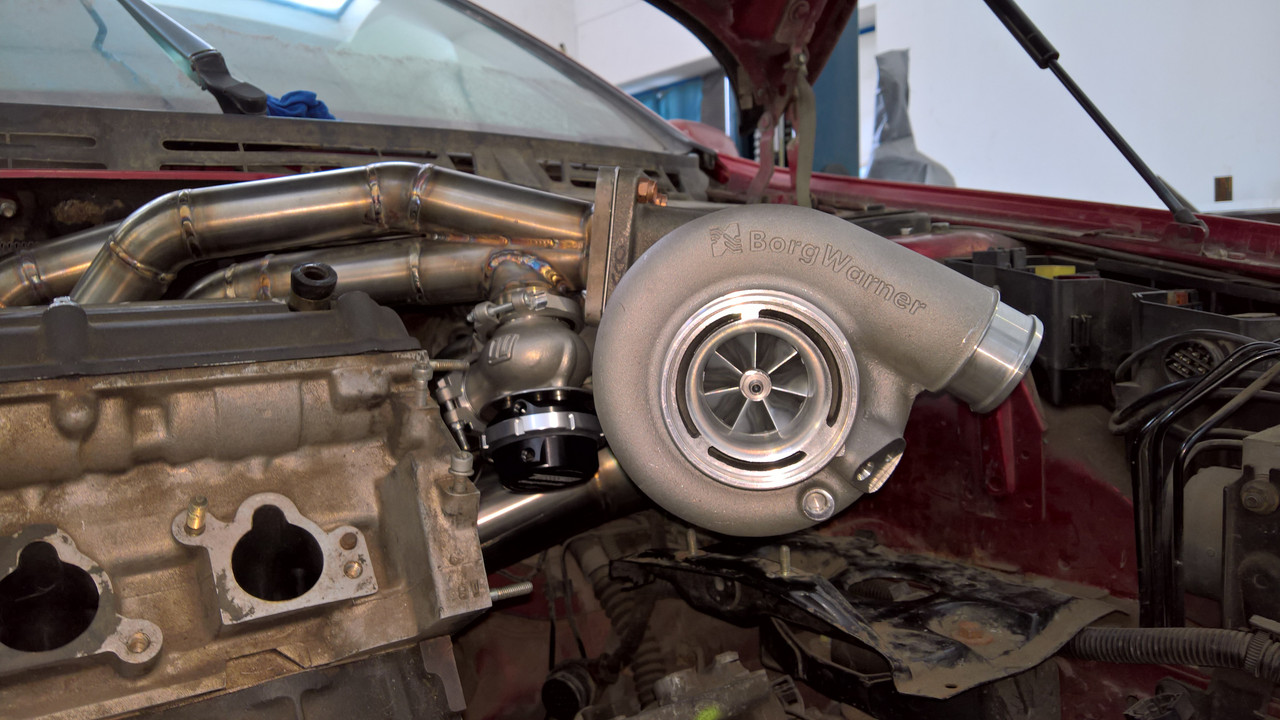

Loving these updates, how has your previous gearbox been handling the extra torque?
What sort of power / torque figures is the engine making?
Posted 12th Jul 2019 at 18:51
IvayloPavlov
Location: Sofia,Bulgaria
Registered: 06 Aug 2012
Posts: 265
Post #171

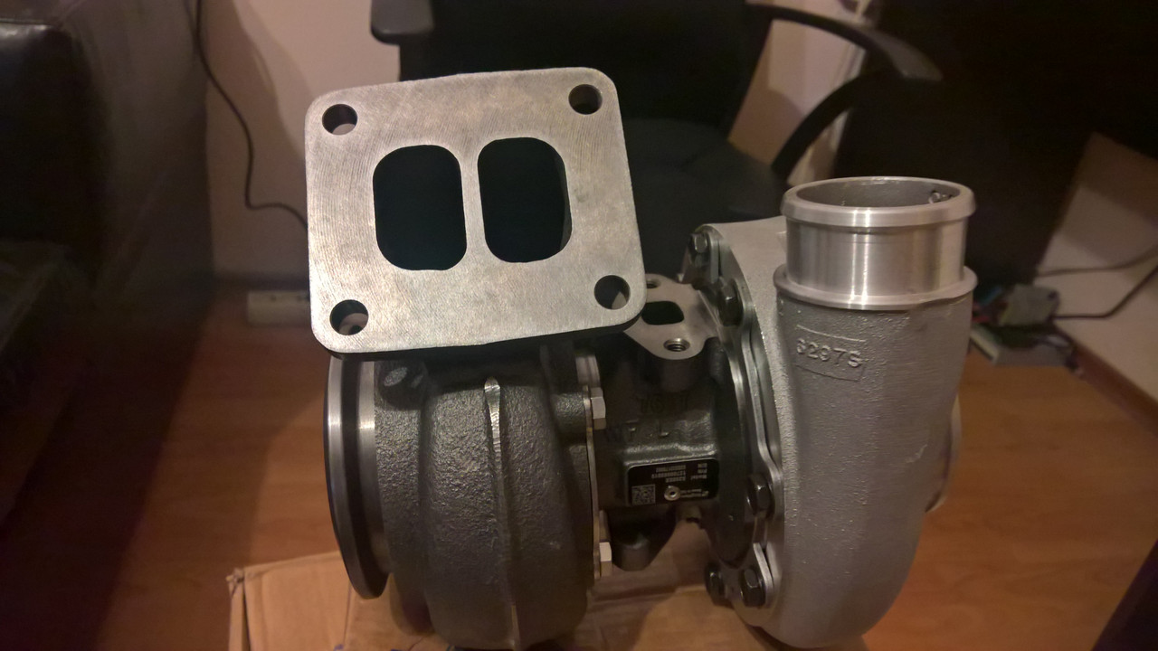

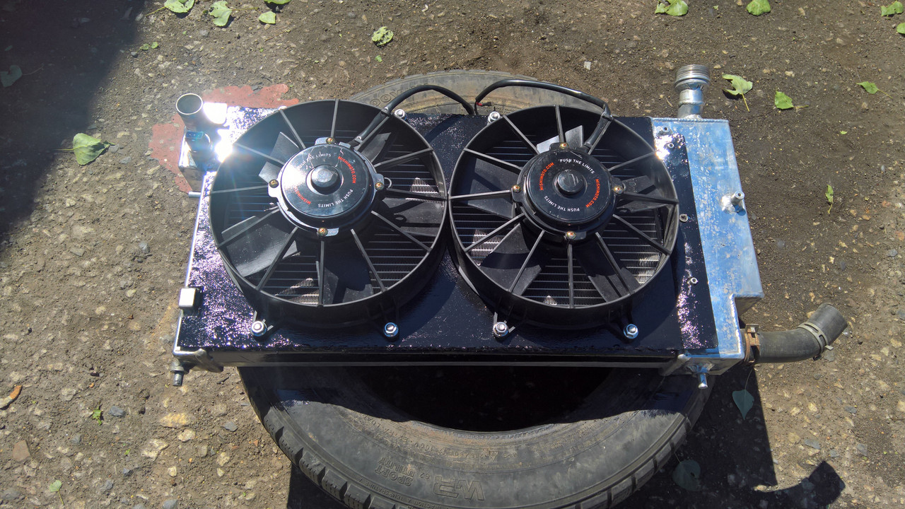

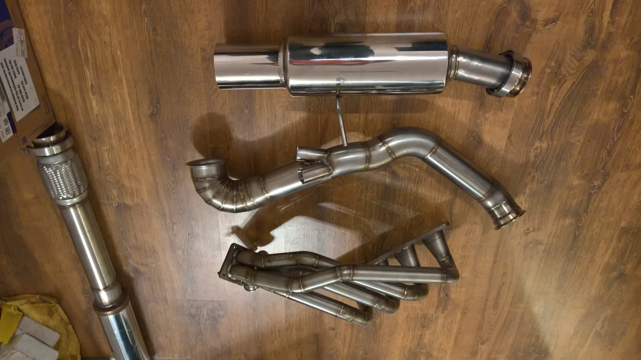

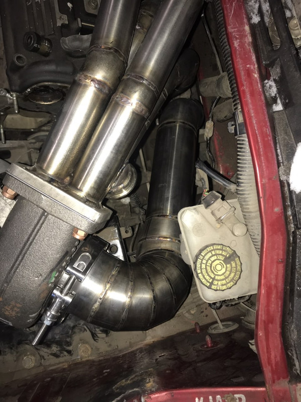

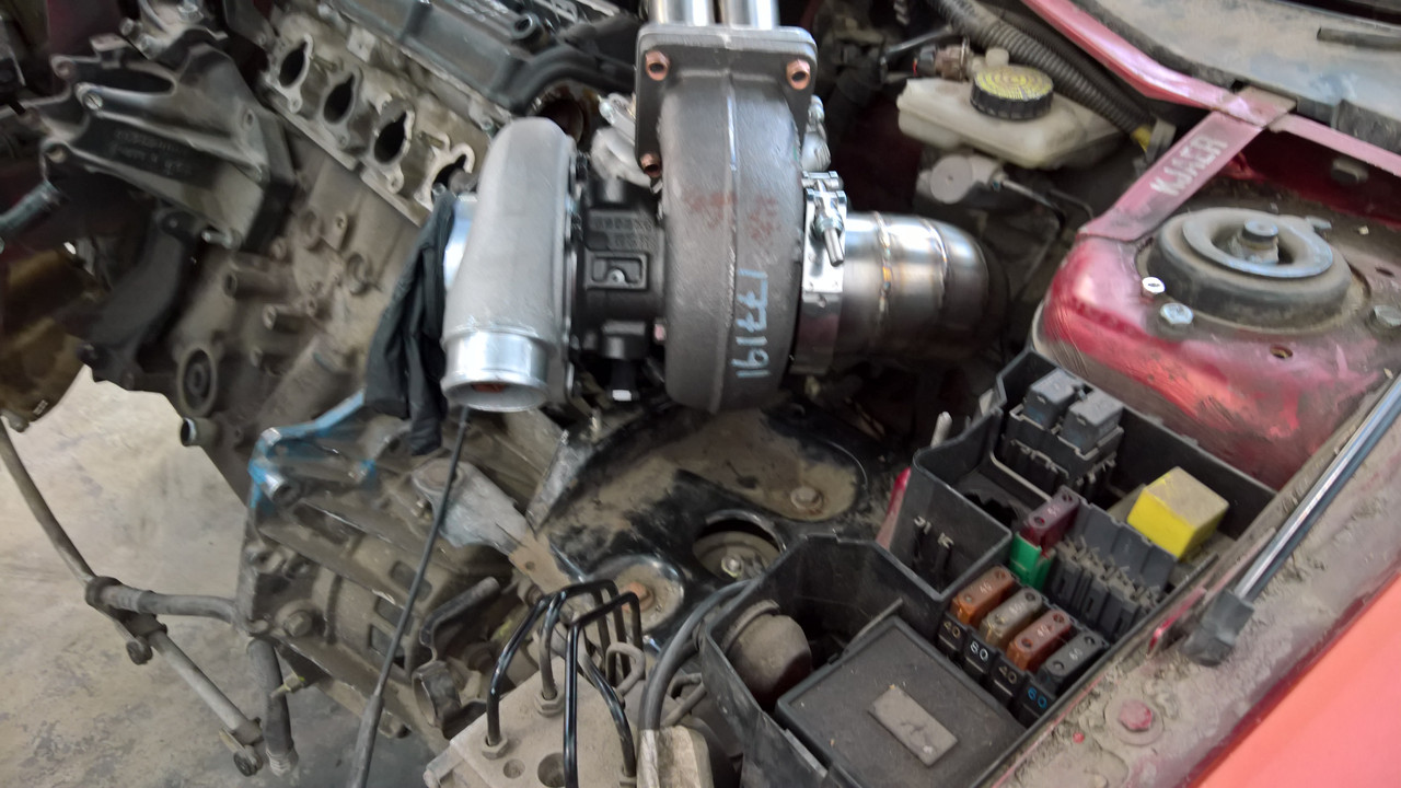

There is no problem at all. I was running standard GTI6 box with Quaife differentials and custom made ceramic clutch. The car was ran only 2 000 km after I put all together @ 14 PSI of boost. I haven't measured on dyno yet, but due to low compression I expect no more than 300 BHP. So after I have changed the bearings and the clutch I am going to high boost +25 PSI.
Here it is what I have as a parts:
customs JR pistons CR 8:1
custom Pauter rods with ARP bolts
King Racing bearing

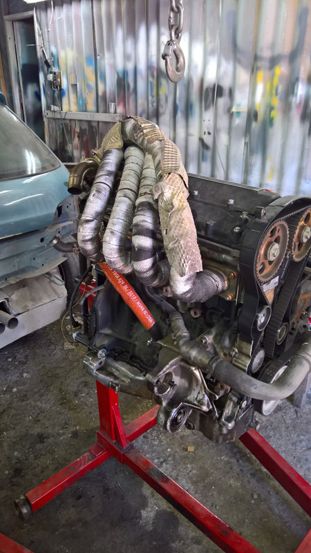

SS custom exhaust manifolds & downpipe @ 3.5"
SS custom exhaust pipe @ 3" with central Magnex and no brand end box

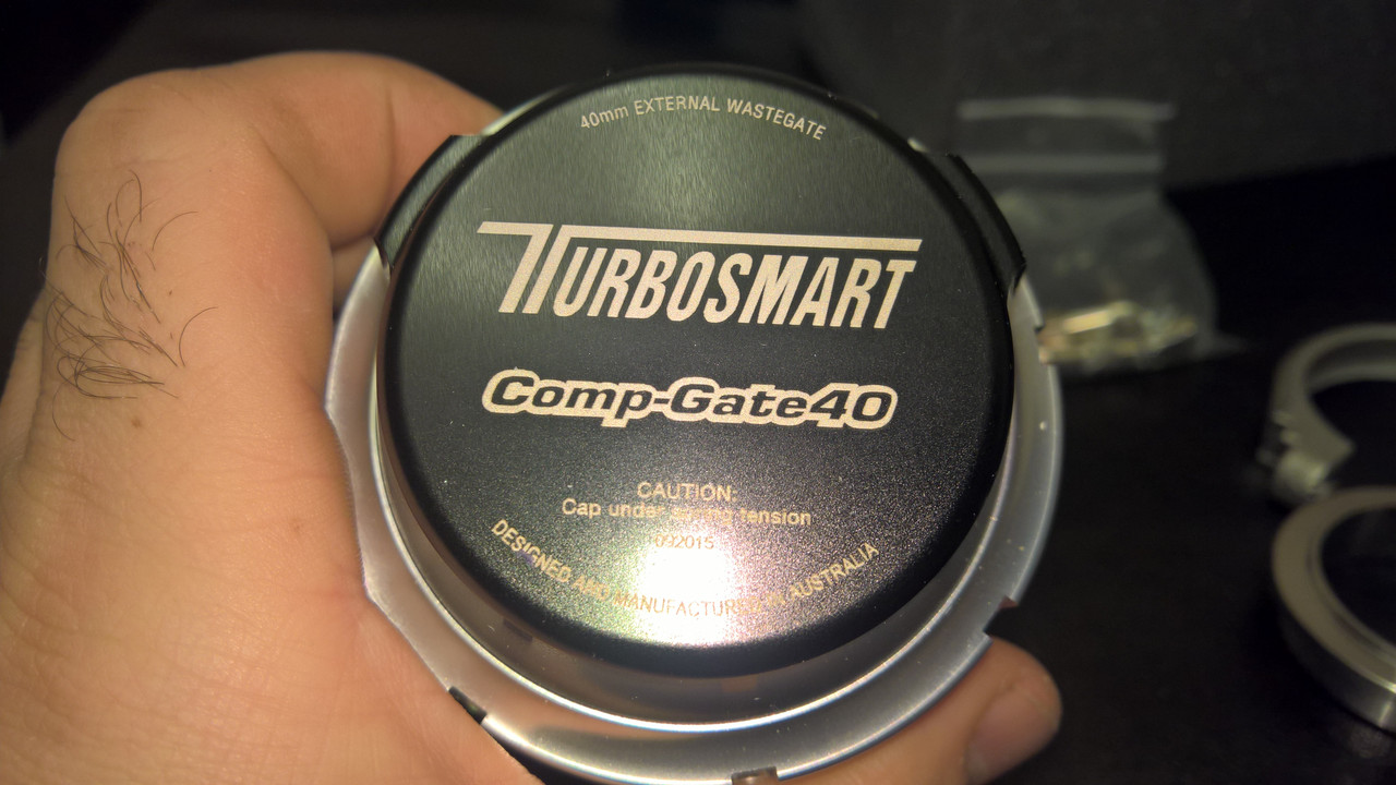

2 * 40 mm Turbosmart wastegates
50 mm Turbosmart BOV

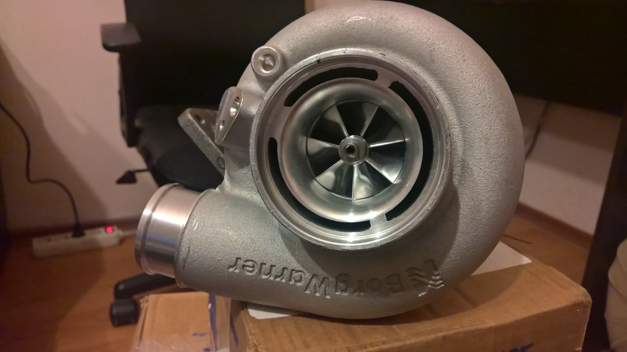

BorgWarner S200SX-E (the S252) with 0.83 AR twinscroll hot side
13 liters FMIC Mishimoto
inlet turbo pipes at 2.5'
Mocal oil cooler

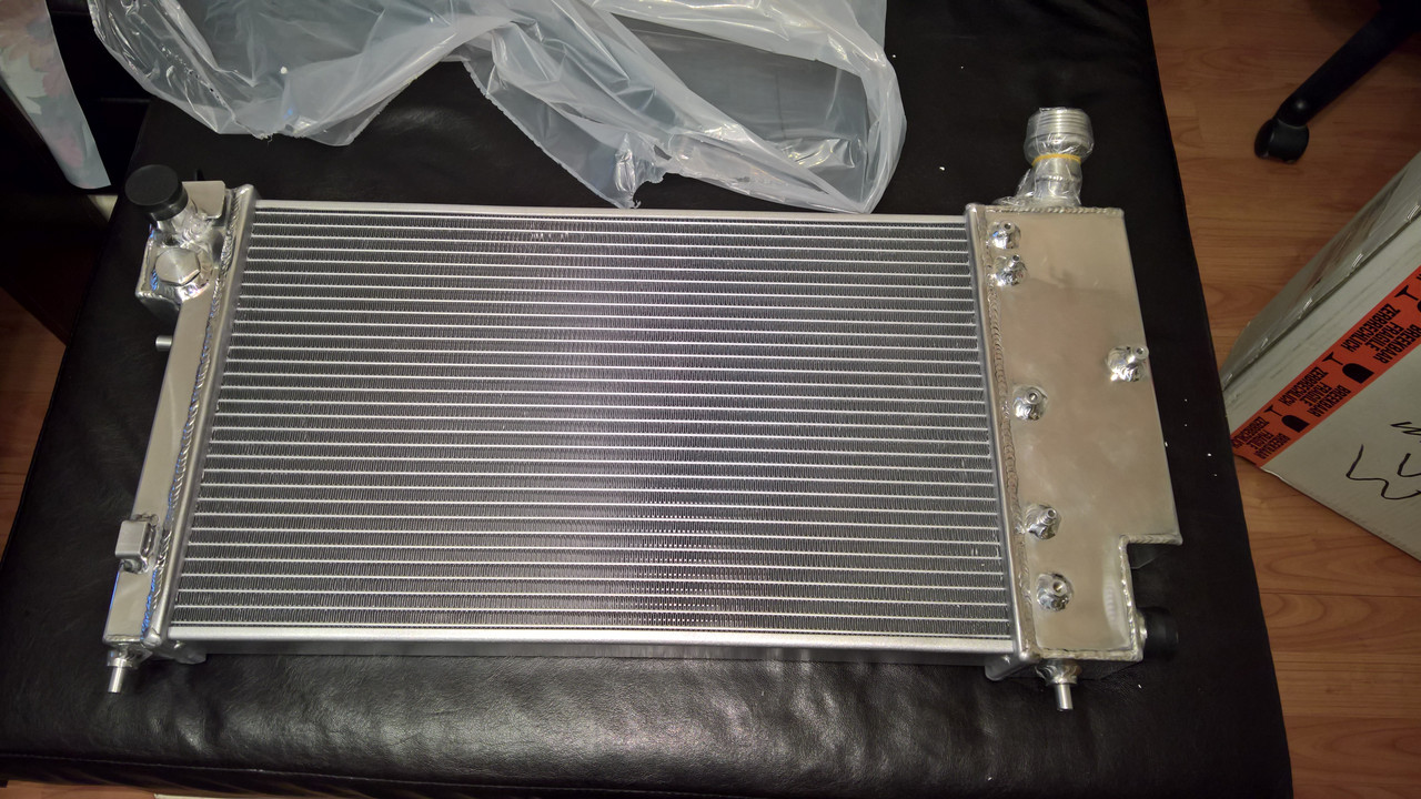

Aluminum water cooler
2* Mishimoto Heavy Duty fans with custom shroud
custom fuel rail
1 000 cc Bosch motor sport injectors
2l swirl pot internal 044 Bosch motorsport fuel pump
AN8 fuel lines & AN6 returns
Sard fuel regulator
Red top VAG coils
Megasquirt 2
VTS BE3 5 speed gearbox with 205 1.8D Differential
ATB Quaife
Helix clutch
KW v1 coil overs with KAD top mount
VT engine mount
Polyurethane arm bushes
406 Brembo 4 pot with C5 288 mm front discs
Rear Apex dampers
Solid rear mounts

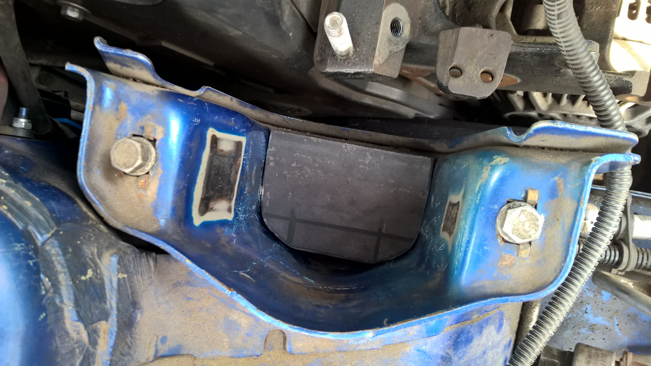

Posted 13th Jul 2019 at 09:31
IvayloPavlov
Posts: 265
Post #172
Posted 13th Jul 2019 at 08:49
IvayloPavlov
Posts: 265
Post #173
Posted 13th Jul 2019 at 08:50
IvayloPavlov
Posts: 265
Post #174
Posted 13th Jul 2019 at 08:58
IvayloPavlov
Posts: 265

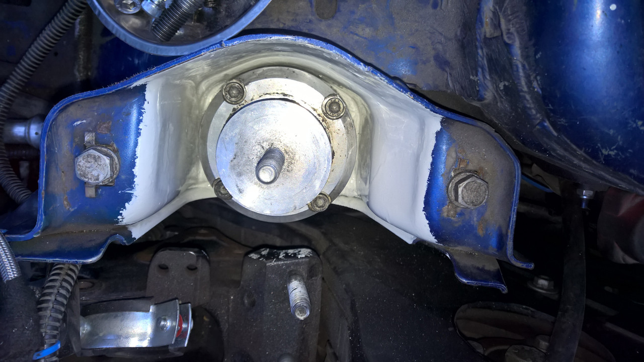

Post #175

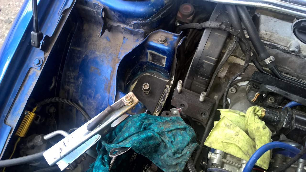

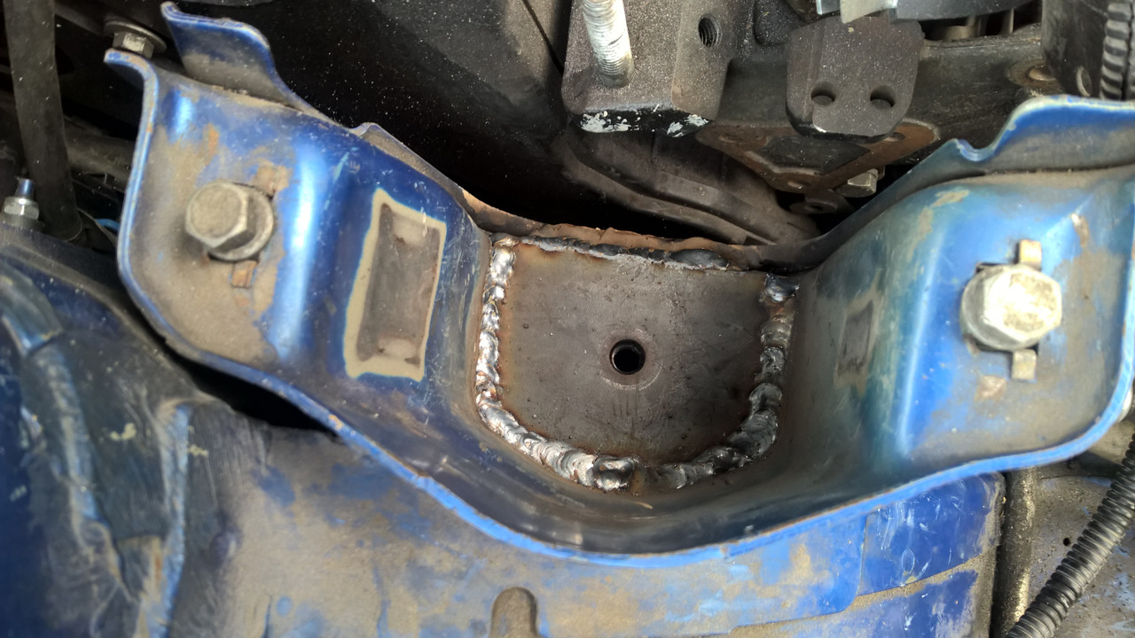

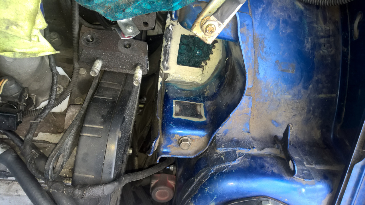

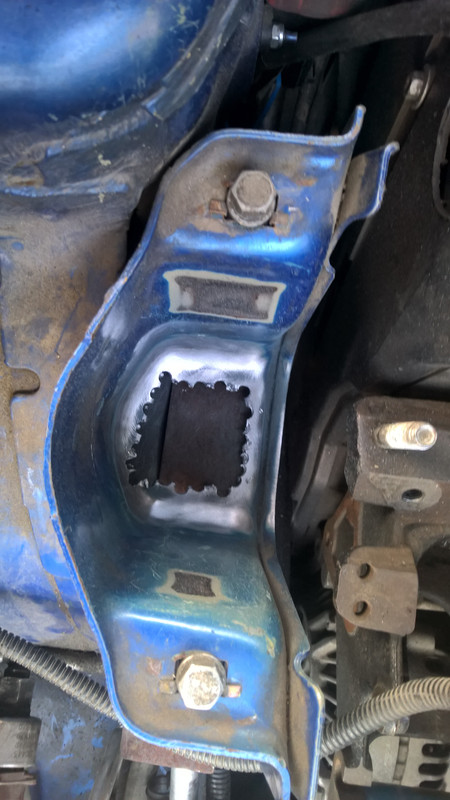

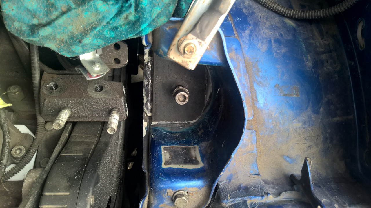

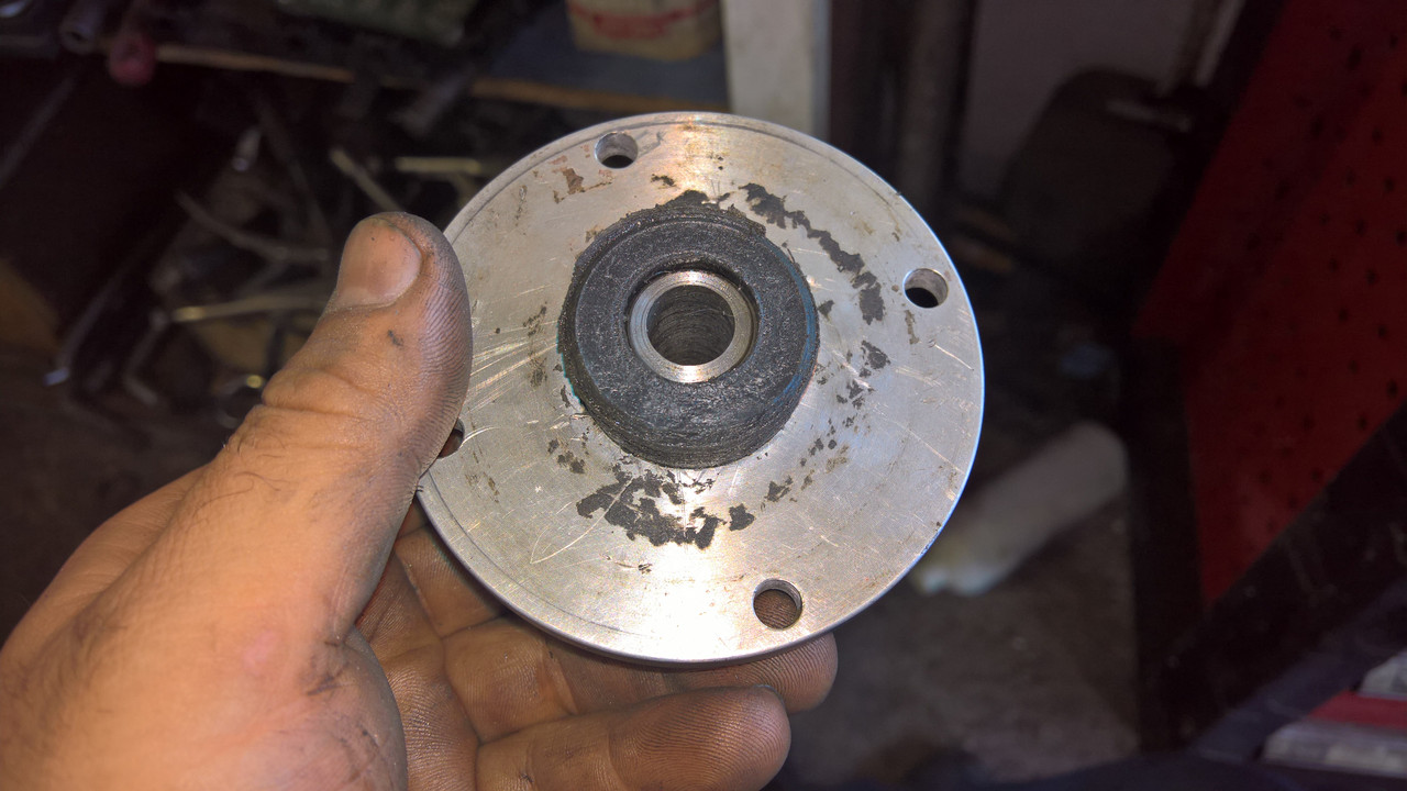

Uprated VM upper engine mount Smile
Posted 13th Jul 2019 at 09:15
