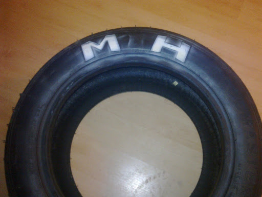

haven't been doing much on the car lately, but now i have all the things and next weekend i'll start putting it together :-) The first race is late april so plenty of time
The new Kaaz lsd
The New MH slicks, so i need to get standard front brakes on again :-(

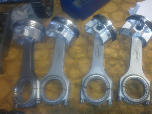

got some work done this weekend and the engine is almost finished. Just ned to get the clutch og gearbox back, then i'm ready to put it back in the car :-)
Can't wait :-)
Nice tool but it's not used much
98mm crank
NMB1022 -- ZX 2.3 16v
http://www.bilgalleri.dk/html/gal_visbil.asp?ID=178755&ipc=548610
Posted 20th Mar 2010 at 22:31
is it a custom billet crank?
261Nm / 192 lbft is very nice on a standard gti6 intake, not tempted to use ITB's?

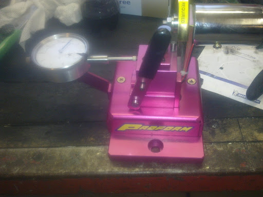

what is the job of that Proform gauge?

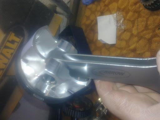

Yes it's a billet crank. It also available in 100mm and a new 102,5mm stroke. The it possible to make a 2,5l xu engine :-)
It's running over 200nm from aprox. 2000rpm and up. Have a homemade set ITB but i'm planing a garret gt35 setup soon. Then we are aiming at 500hp :-)
It's not a standard GTI-6 intake. It has been open and changed on the inside

Vts_tibi> it's a pistonring grinder. The gauge is a micrometer to see how much you grind

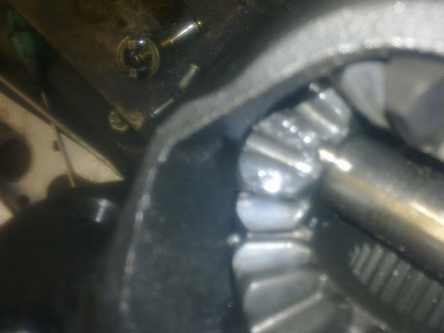

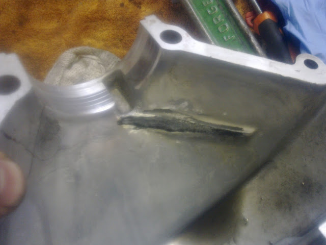

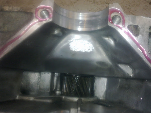

Got around to changing the diff to a kaaz. The old diff had some damage but it seems like the box is still in good condition
It was almost a bolt-on job but i had to grind a litlle bit in the diffhousing to clear.....i won't tell how much time i used to find the clearance problem :-(
