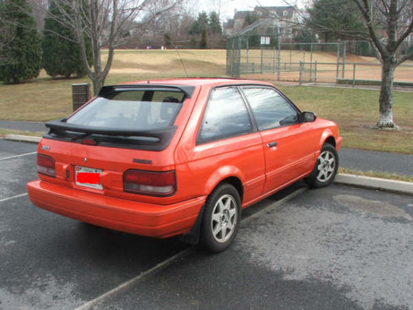

Well technically half my brothers and half mine. On xmas day, we bought a 1989 Mazda 323 4wd Turbo for

There's one in decent condition on eGay at the mo. Our alloys are different and we are changing the rear spoiler to a set like this:
except colour coded without the gash rear bumper.
