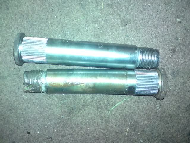

Ok guys, if any of you got a bit unlucky (or happy with the handbrake Whistle) over winter, you may have bent a stub axle in the rear trailing arm. Thankfully it's a piece of p*ss to replace (thanks to Carl aka mechanical_repairs for the part), all you need is a basic socket set and a BFH.
Thought i'd throw this together seen as there was no FAQ bout the stub axle, and it means you may get away without having to replace the trailing arm.

Either way, once the hub is off, hit the stub axle end-on. HARD. a LOT. Don't be scared about bending anything, just make sure you hit the stub axle end on, and don't slip off and hit the caliper. Best make sure the car is stable on its axle stands before doing this, it takes a fair beating.
Now you should see a little rod something like this, this is the removed old stub axle (bottom) vs the new one (top). Note how bent mine was, it meant the top of the wheel stuck out about 3 inches further than it should do!

yep done this a few times, sometimes if the stb is very bent it wont come out tho. Also i remove caliper complete so leave pads etc in. Remember hitting out the knackered stub is fine, but you cant do that to a stub you want to use from another arm so i press them out to avoid damage

Good point, Carl pressed one out for me and posted it up
